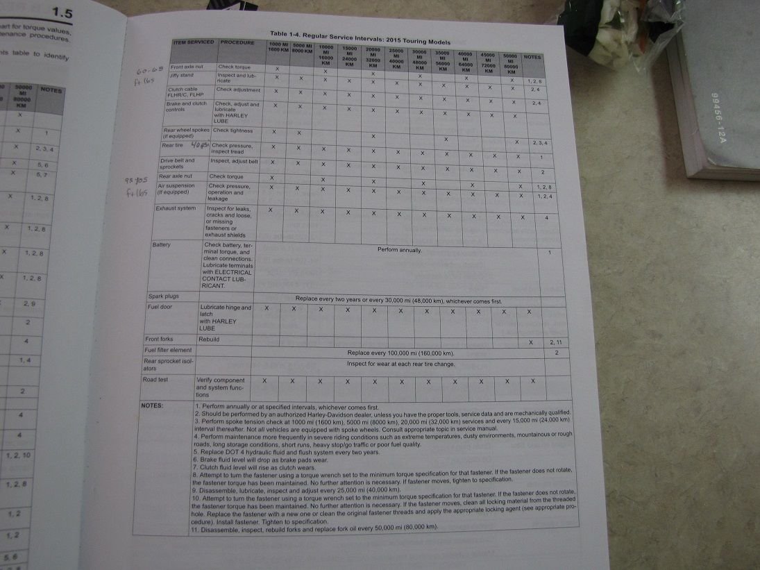

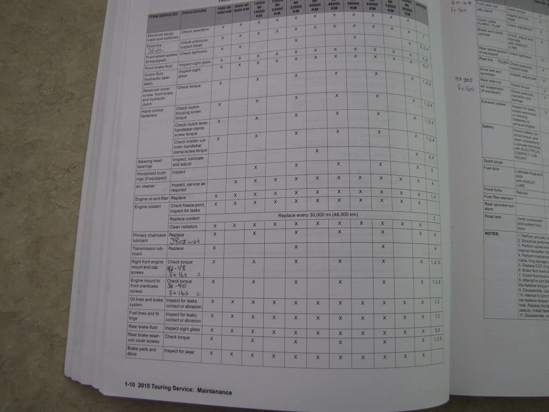

You might have a schedule for a different bike?
2015 manual has steering head bearing inspection and lube at 25K.

The 2014-15 steering head has to be taken apart to service , this is done on the 25k service, 13s and older had grease fittings for servicing every 10k miles.
The check list i have 10K my maintenance manual says 25K, Thanks for pointing that out.
