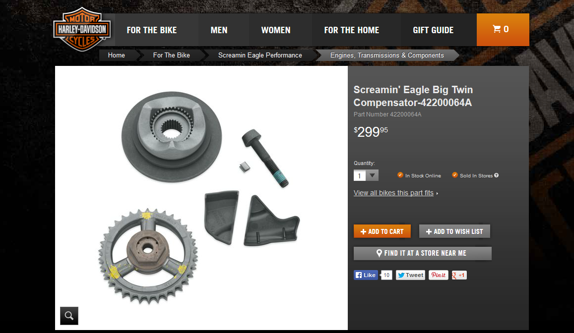

Originally Posted by Eunoterpsia
I thought I read where earlier versions of the SE Compensator included the rotor?
40100061 includes rotor for 409.95 for pre-11. OP has 11 so no need for rotor replacement

maybe I'm just too damn tired... What is the purpose of having to purchase a new rotor with the upgrade to the SE Compensator.
I see the 30041-08A Rotor costs basically 100.00)
Not compatible with older style rotor on pre-11 touring bikes
