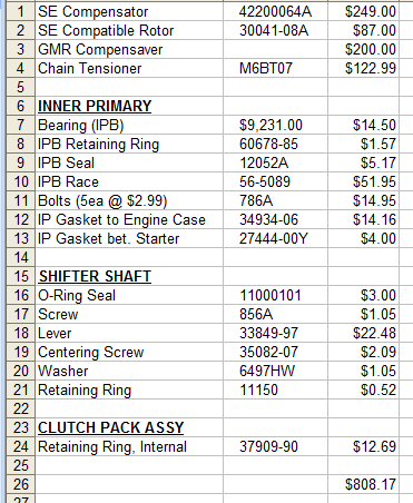

Well, here is the situation from my perspective...
The 40100061 SE Comp Kit with the 30041-08 rotor $336.
42200064A SE Comp Kit $249 + Modified Rotor 30041-08A $87, total $336.
I do not know the difference between the 30041-08 rotor included in the 40100061 "Kit" and the 30041-08A rotor which must be bought separately but I'd rather have the modified part.
Here is my parts list...
