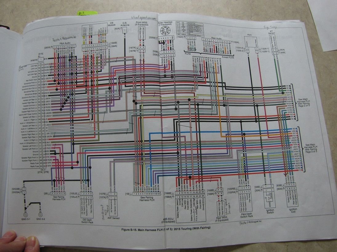

It's the P&A 20 Amp circuit. This circuit is everywhere, Heated grips, Accessory power, Power outlets, PA Audio & CB, OE and PA switch Packs, Accessory connector 4A. Power originates at the P&A fuse and goes through the P&A relay. Aux Lamp power comes from BCM.
Have you added anything to the Accessory switch, changed bars or have something plugged into accessory connector 4A under the left side cover?
