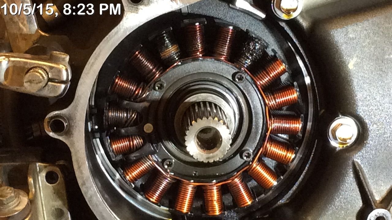

Duracell's Avatar
Duracell
Joined: Oct 2007
Posts: 2,806
Likes: 1,754
From: New Bern NC
No question where the problem is here. Went ahead and picked up a stock unit in the way home. It was in stock and I can't pass up the fall riding weather.
