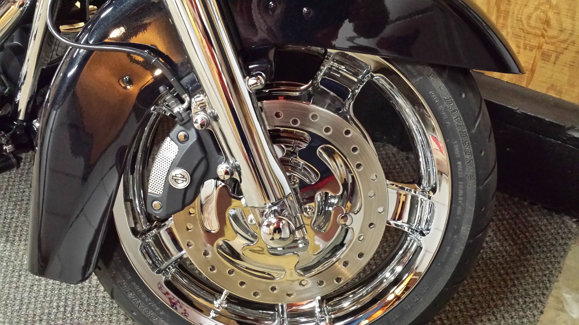

Cowbells and rotors. Found these chrome stock rotors on e-bay.
