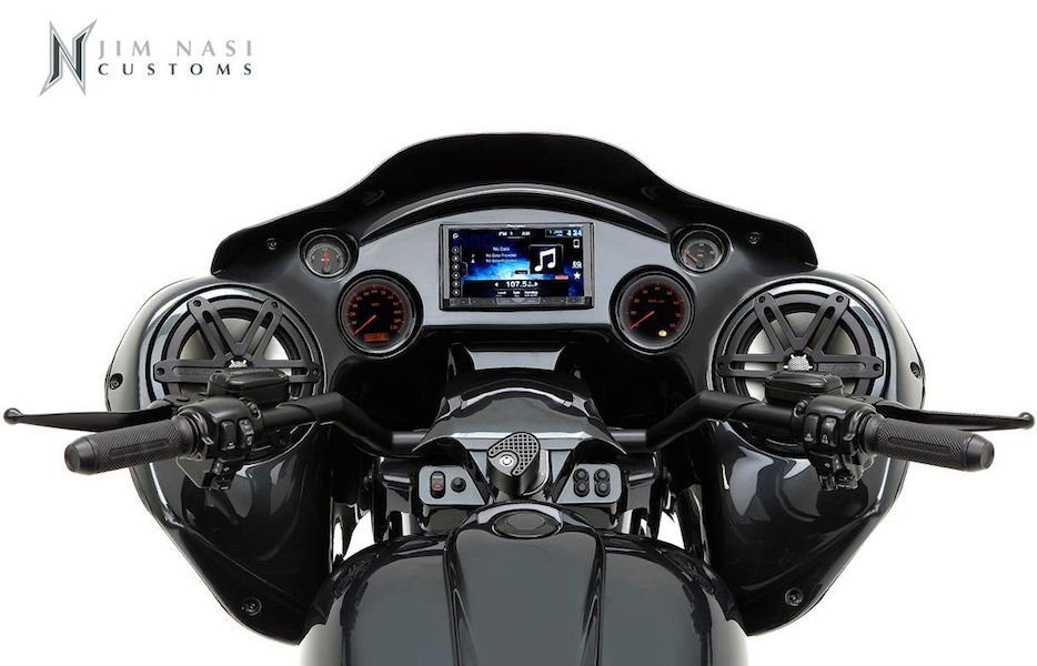

This is the inner fairing I am going with! I think it is pretty bad A!
So you are telling me I can buy a used 6 gallon tank and it will mount right onto my frame? Or do I need to stick to a 5 gallon tank from 97-07?
Also I think I will be using the Hells Fury adjustable mount. I am about 6'3" and I think It will allow me to adjust the fairing setup just the way I need it. Also I will be using some of the hidden fairing supports so I don't need to use a crash bar. If I decide down the road to and add the vented lowers then I will do that at that time.

That's a nice looking fairing though, should be pretty cool. And your cam upgrade list is solid too!
