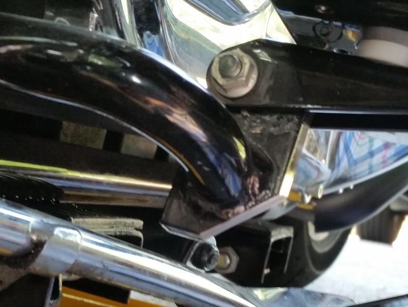

Yes on the Tall Boys and yes on the 4588s. Fwiw, the Kuryakens would be a good place to start because the concept of moving the boards out vs the mounts still applies and should help your situation. To me, moving the brackets out is a recipe for disaster.
The Tall Boys brackets were purely for comfort. They won't help with clearance at all. That said, I ride fairly aggressively and I haven't had an issue after I gave the brackets a haircut -
Note the angle cut. It used to be squared off and I touched down a few times so I gave it a trim. No issues since.
