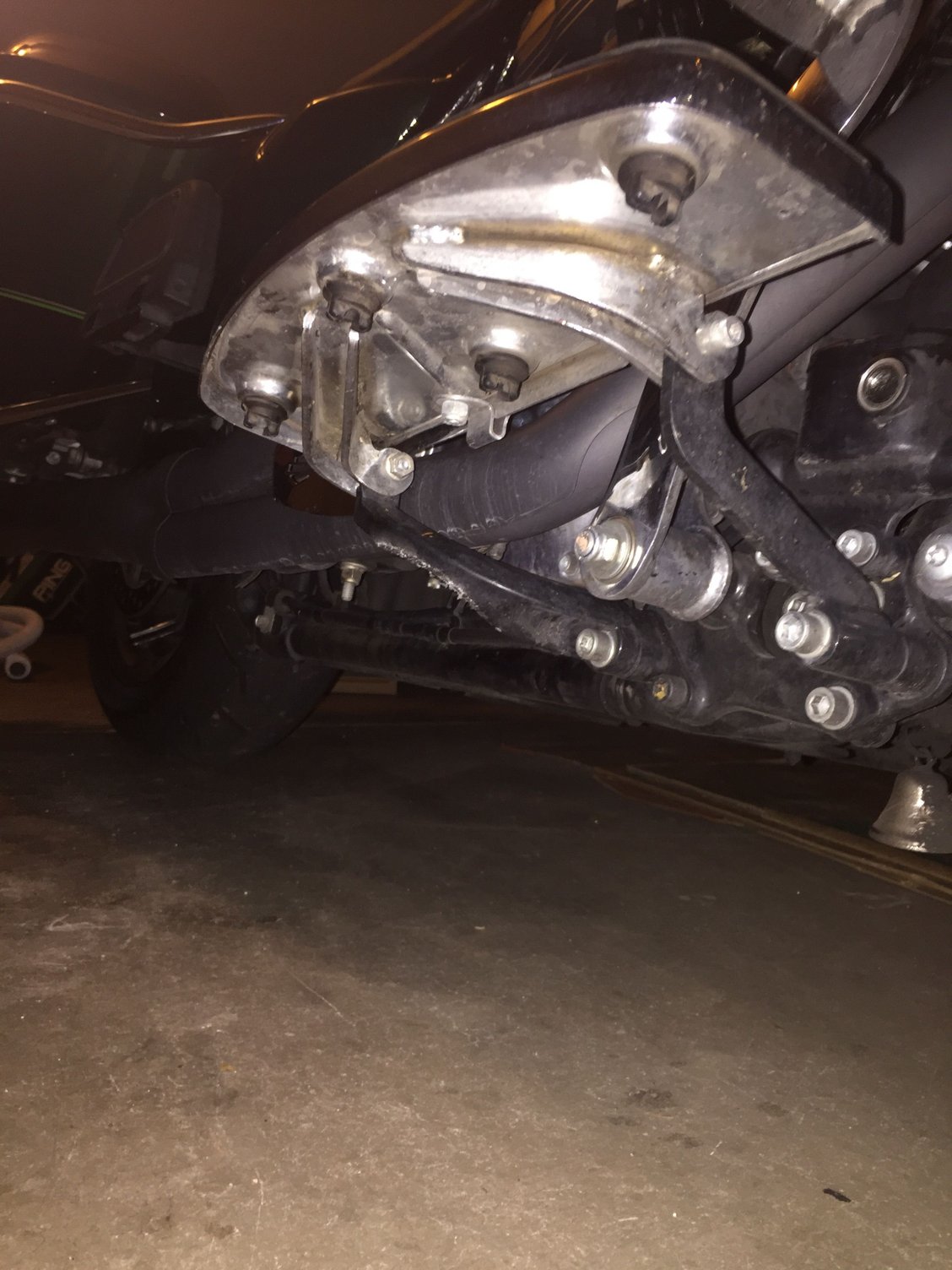

Originally Posted by Sedonastrider
It seemed that the footboard dragged before the footboard bracket did in the past. I did the extended reach rider footboard pans (1" forward) and the footboard bracket spacers (3/4" out). Those mods have been on for a while, but my riding style hasn't changed. I guess the footboard going forward has allowed less of the footboard to grind first?
Anyway, when I felt the lever effect from the bracket grinding, I stood the bike up immediately. I was going about 15 around a 90 degree right hand turn. Am looking for ideas on peg feelers that sport bikes have for the unlikely event I get into it that hard again. Maybe there are aftermarket brackets that are more ideal. I did find these:
http://www.tallboyscycles.com
Open to constructive suggestions and not so much lectures about riding it a little too hard. Below are some photos showing what was hitting and how little the floorboards were in road contact.
I would mount a feeler off the rear floorboard bracket bolt. Maybe a piece of titanium on a thin enough pieces of steel that it would flex a bit (and not lever you) but still make some noise and some sparks while you're at it.
That could be a good idea
Could be fun too.
Here's a link for the feelers that make lots of sparks-
http://www.gmanindustries.com/shop/p...00%25+Titanium
Just a matter of some steel stock to bolt it to, and that would bolt to your bracket.
