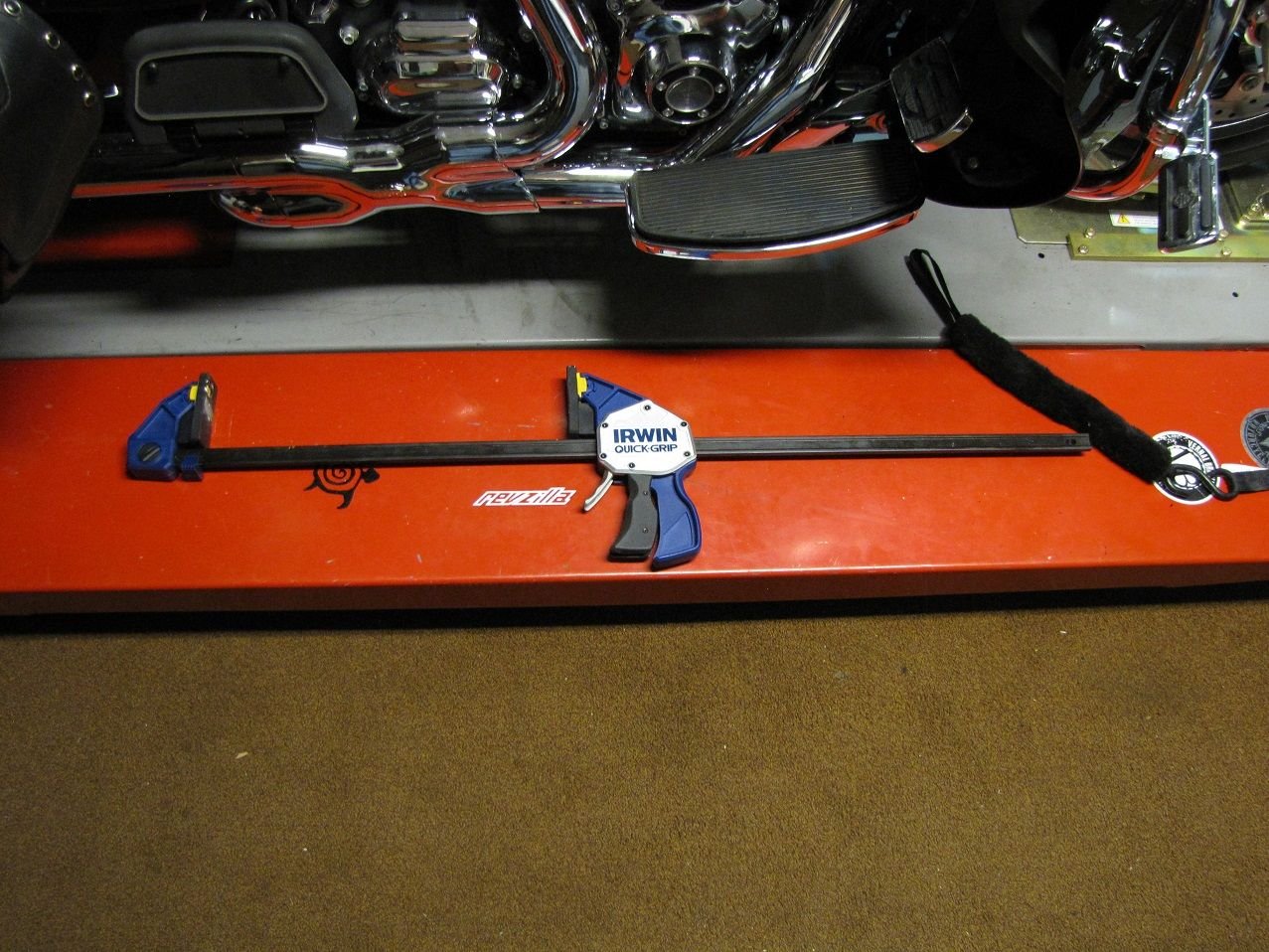

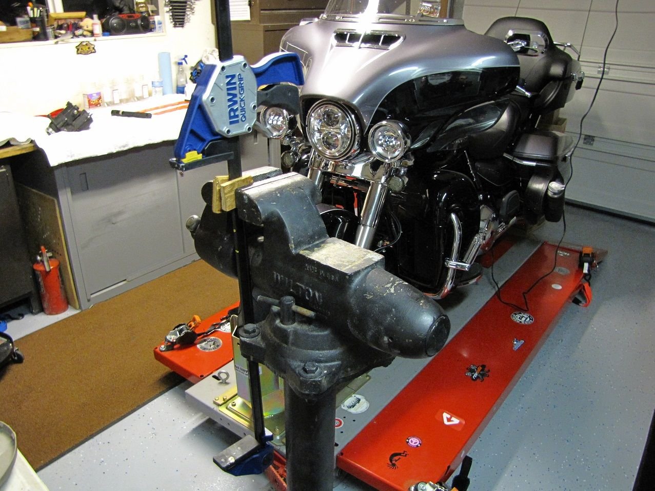

I've done a few sets and found this Irwin Clamp to be the extra set of hands I needed to do the job.

That is the pretty much the way I did it with the Irwin Clamp in post 15. Secure the clamp in the vice then put the tube and cap in the clamp and compress the spring a little and screw the cap on or off.
