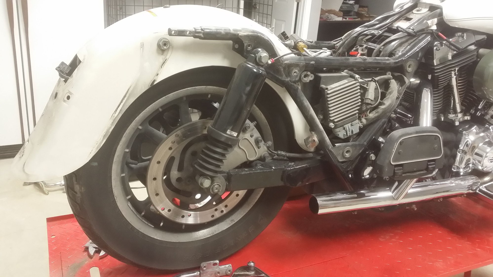

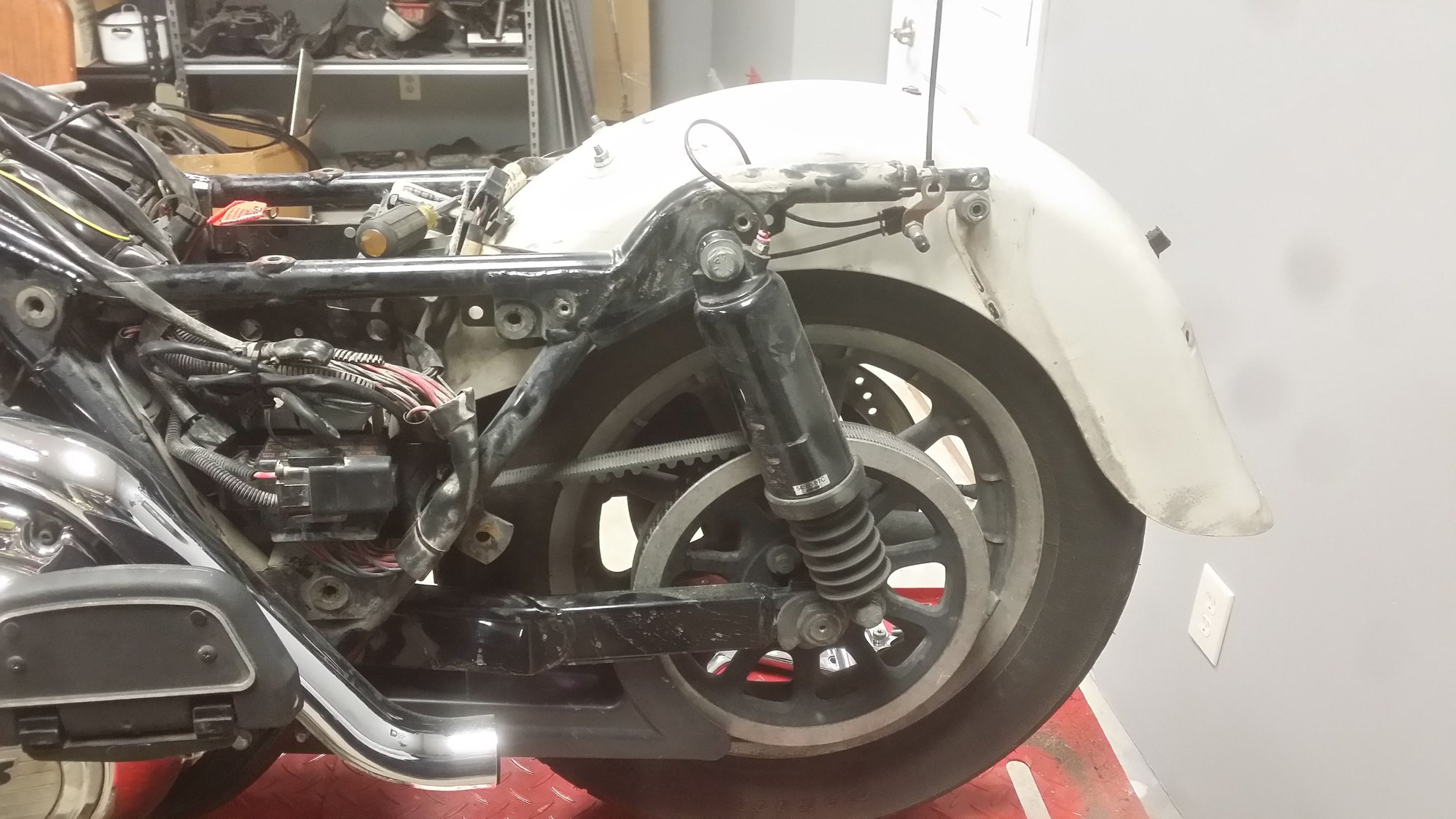

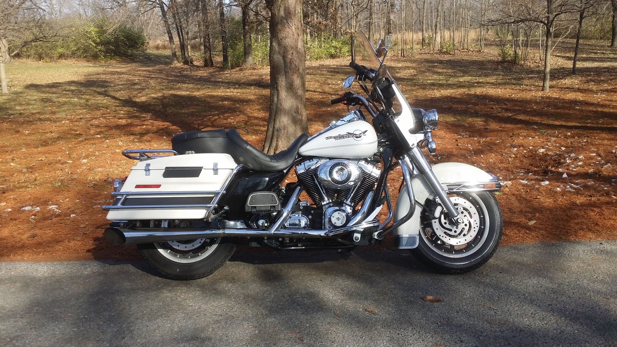

Here is what I am starting with.

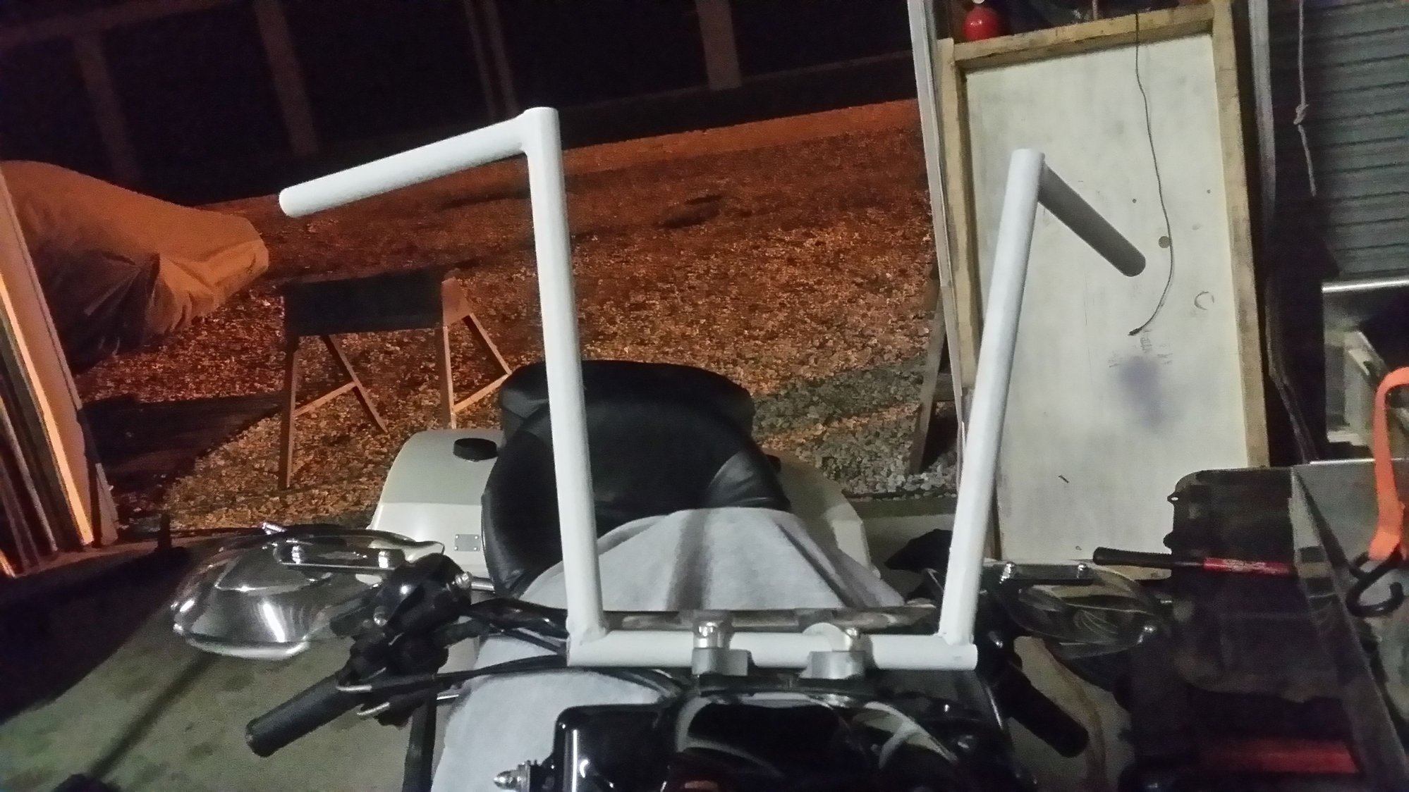

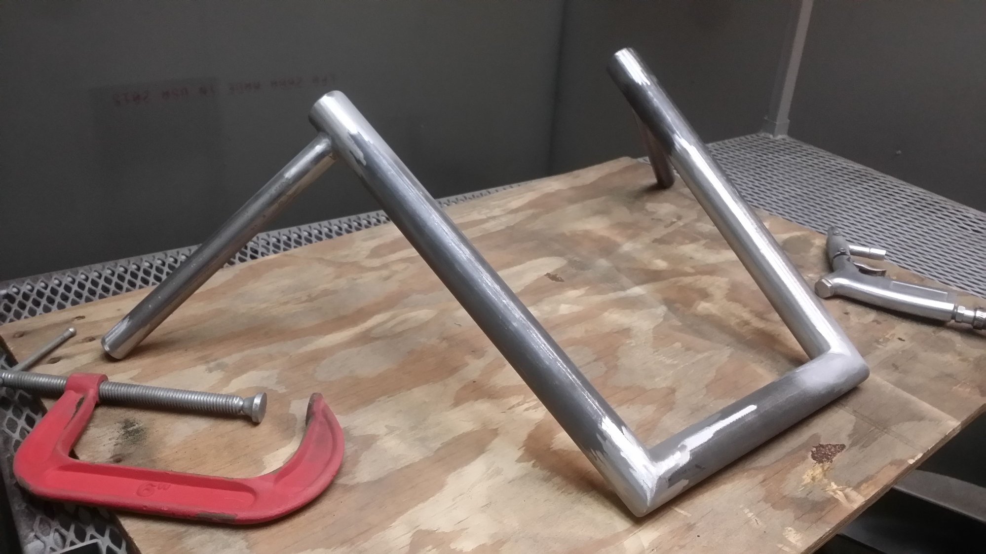

New 1.5" handlebars with grips, 107 Fuel Moto kit with TW777, new rear brakes and disc, new slipons (haven't decided yet which ones), HD textured engine powder on some of the lower engine stuff, then color powder on the rocker boxes, pushrod tubes and bases, satin black powder on the wheels, ceramic on the high use items and high temp satin black ceramic on the exhaust, new tail lights, weld some of the fender holes up, new paint on fenders, gas tank, and the side plastic pos. New Handlebar dash, eliminate the tach. And in typical project creep, we'll see what else is added. All work done in house.
Mock up of the handlebars.
New bars.
