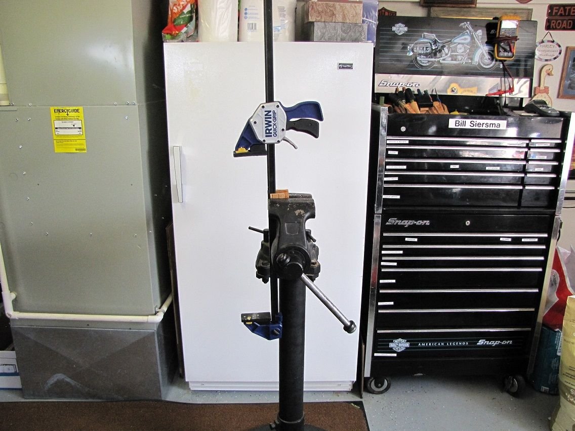

I used a Clamp to help compress the fork tube into the slider to get 25 started back in the tube. When you have the fork tube in the slider and ready to put 25 back on fork tube, screw 24 into 25. put every thing in the clamp and compress it slightly and turn 25 into the fork tube, 24 will unscrew and hold everything in place while 25 goes into the fork tube, a few threads will hold it and you can take it out of the clamp. just a easy way to do it when working alone

I got my 1 3/8 box wrench under the switch cover just by removing the two outside screws and wiggling the wrench in there. Another tip, I didn't have that big *** clamp Vernal has so I took my floor jack, run it under my reloading bench and jacked it up slowly until I could compress the spring/cap enough to get it started. Then slid it into the triple tree claim to tighten it the slid the forks back up and put the top cap on.
