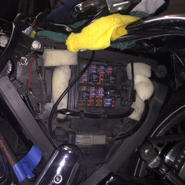

Once of prevention worth a pound of cure?
That depends.
Are you intending to do that temporarily while you wash the bike? If so, that's not a problem at all. I don't think it's necessary since everything in there is designed to get wet when you ride in the rain.
However, if you intend to put that in there and leave it, that would be a very bad idea. It would get wet, trap and hold moisture behind the side covers, and potentially cause corrosion of your electrical components and contacts.
