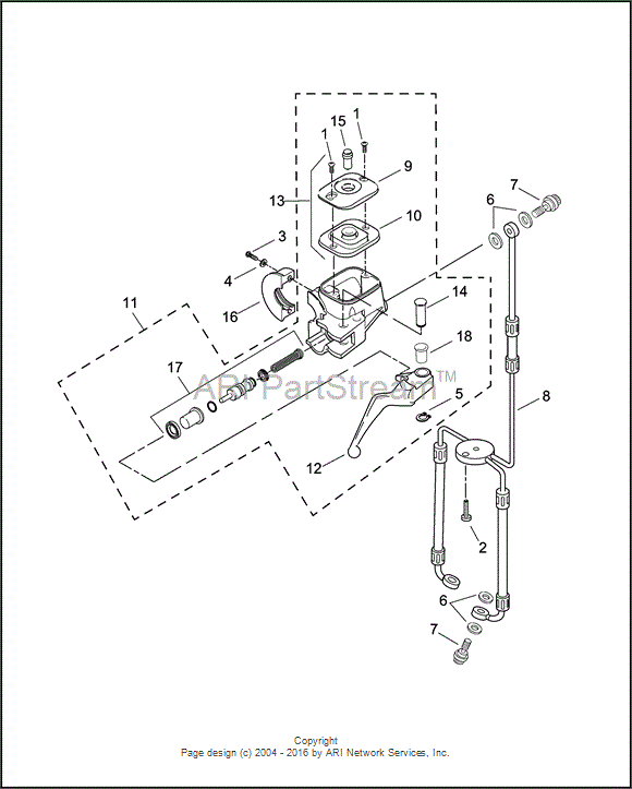

http://www.granitestateharleystore.c...03B%5cT24%5cFD

There is no rattle clip on brake lever only clutch. Get a new bushing, pin, spring clip. Bushing likely worn.

If it's really sloppy after a new bushing and pin you may try a "wave washer". Be sure there is enough room to ensure that it won't bind
