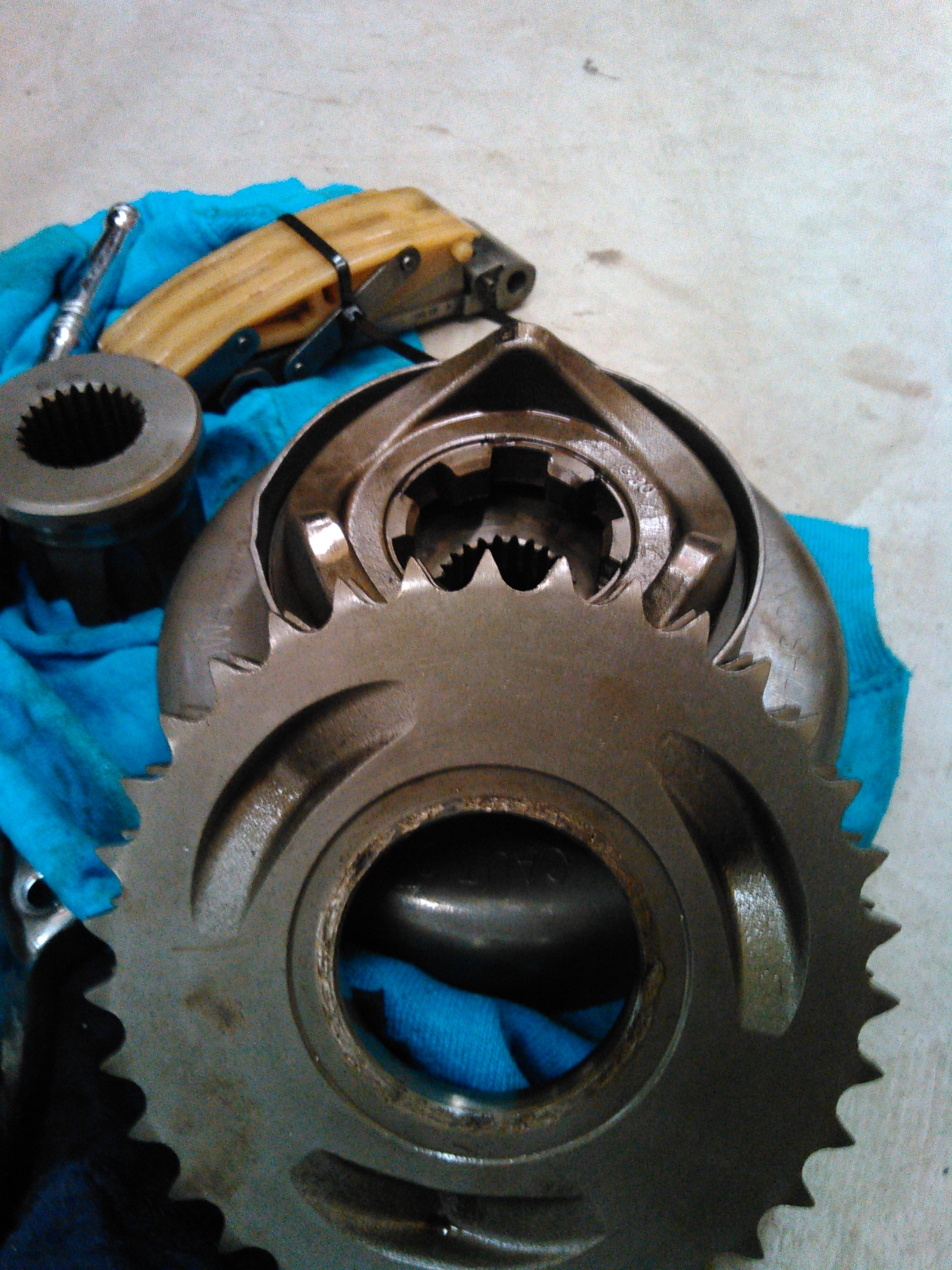

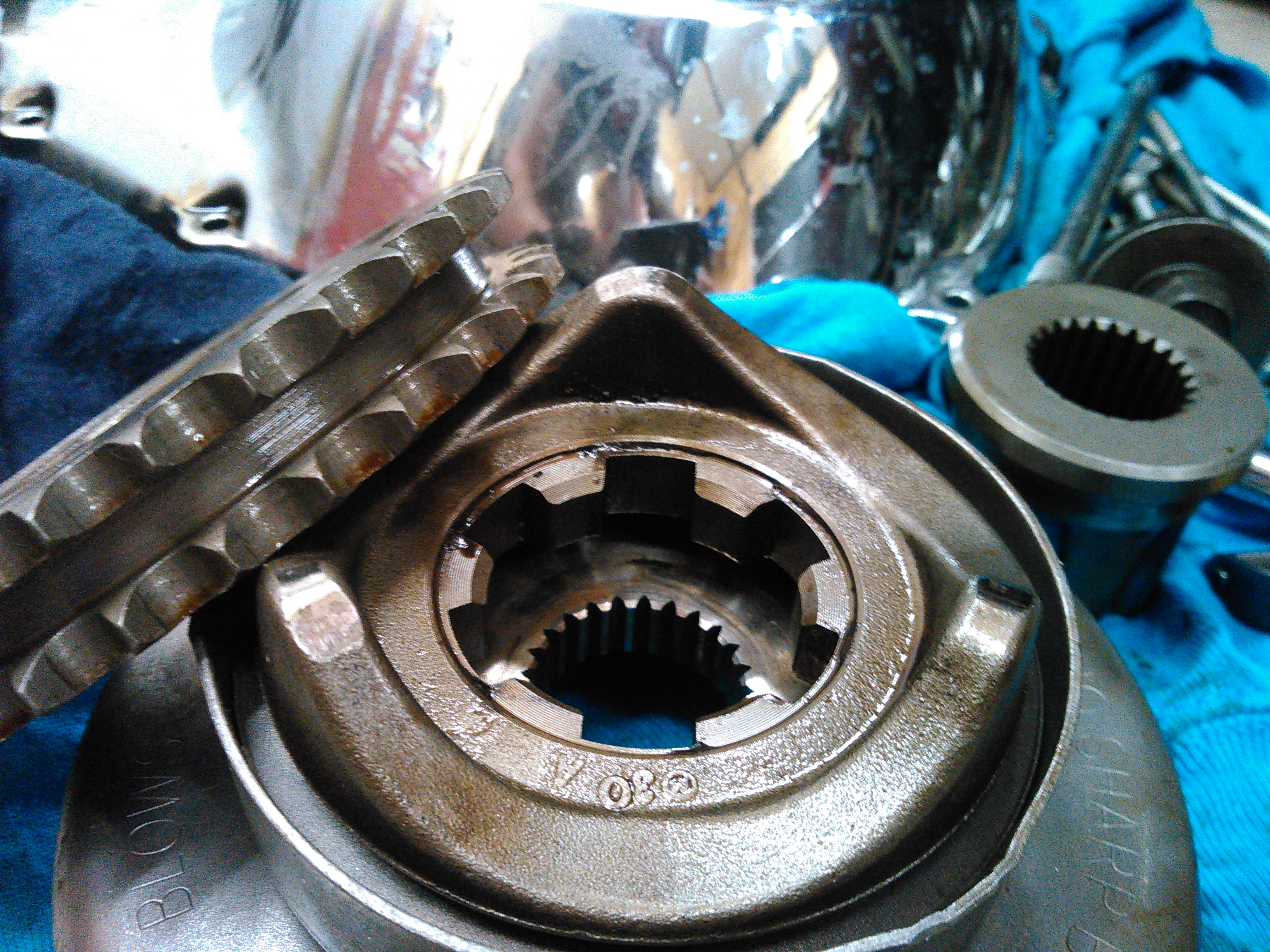

Got my buddy to grab a few pics and send them to me.

It is possible a couple of issues are taking place, of course need to get this problem put back togeather in order to start it and listen. I was hoping to pull the comp then just fire it up but of course that isn't very possible.

Well yesterday I finally had gathered up all the parts. Thanks to this forum I went with the kit from Baker. Very easy to assemble and good instructions.
Started it up and wow doesnt sound like its ready to blow up!
Unfortunately the temps were at freezing so I didnt try a road test but sure seems to be running nice now!
