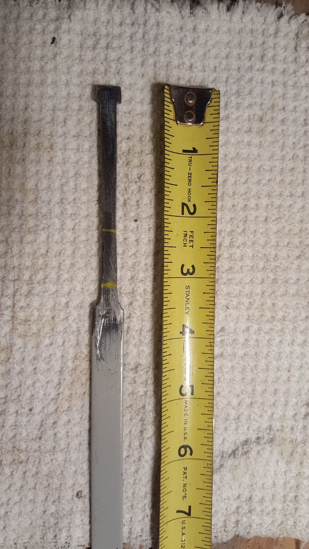

Trunomad - keep tinkering with it, you'll get it. Use a flashlight and look down in the hole. You'll see the notches that have to line up. You don't need to buy a special tool. You can use a long screw driver or make a tool. I made the one below from 1/8" thick by 1/2" wide bar stock (you could use 3/8" wide bar also).
Using this tool, I can drop it in to the first mark at 2 1/4" to turn the upper tumbler. Or drop it in to the next mark at 3" to turn the lower tumbler.
If I remember right, the 2 notches in the lower tumbler are different sizes. So make sure you're lining up the correct notch.
