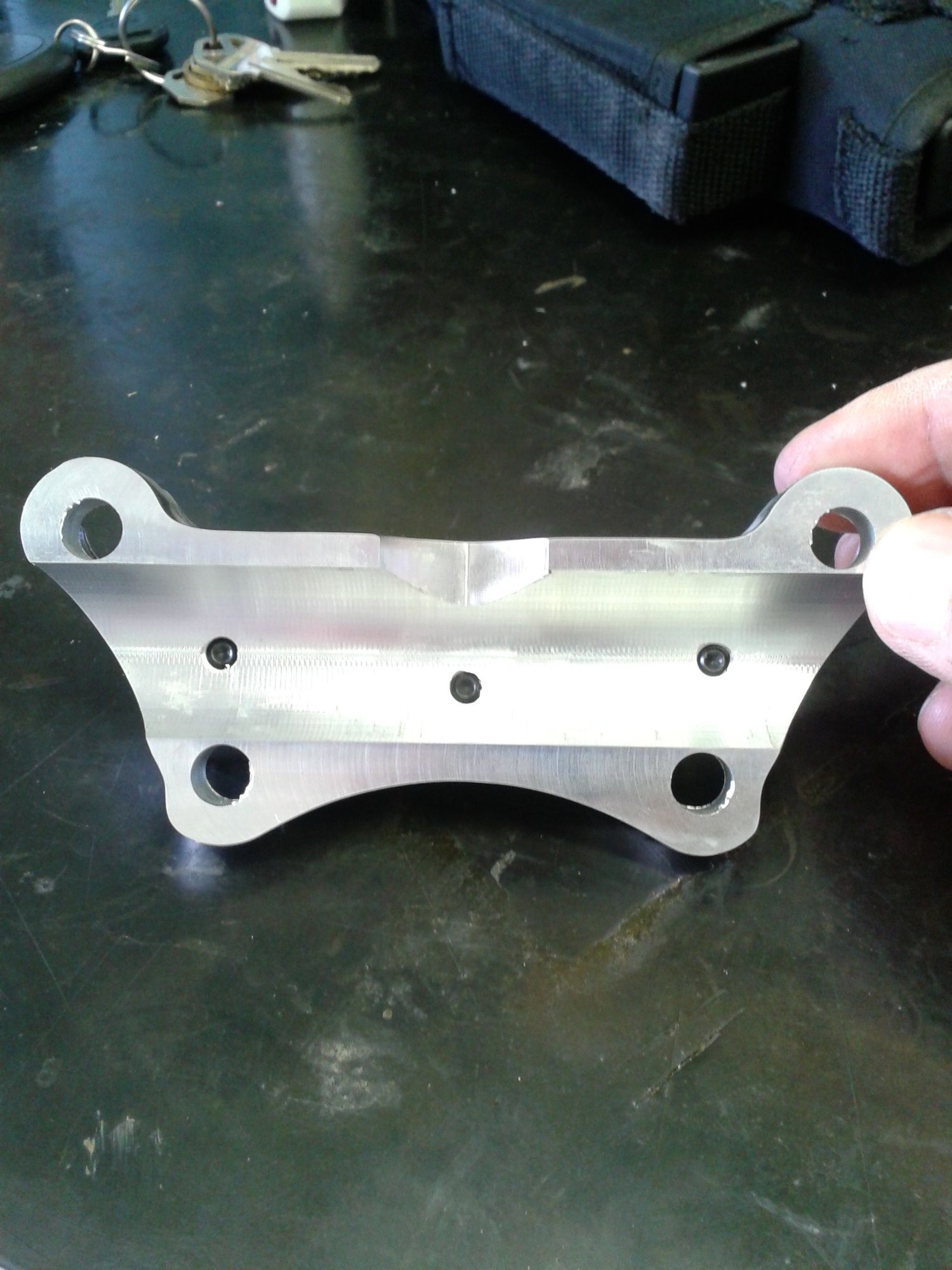

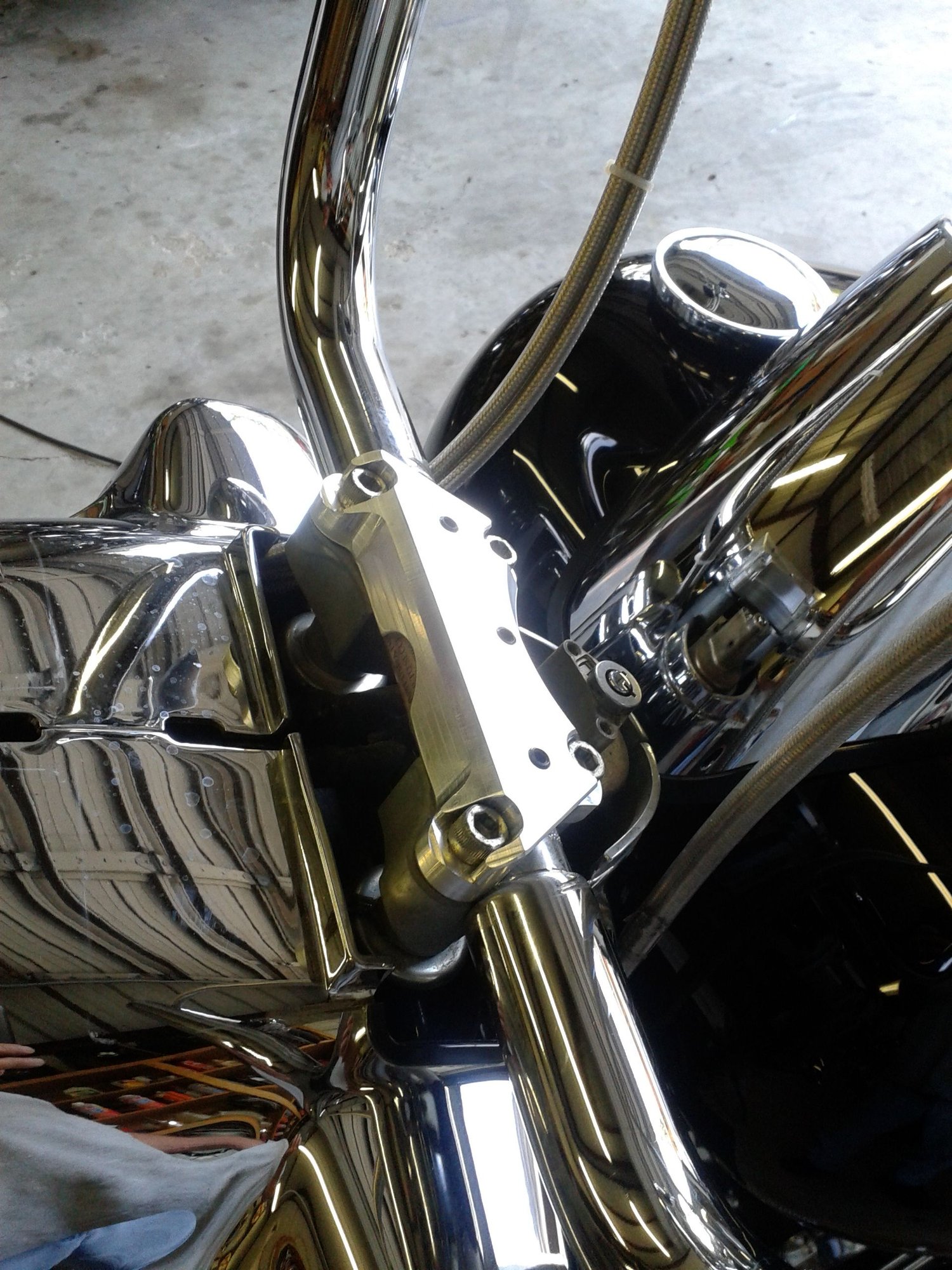

Cool one piece top clamp ...
Originally Posted by BWann495909
Probably could use some new riser bushings. Newer ones are made of a harder compound. Also change to a 1 piece top clamp when you change the bushings
Solid billet CNC one piece top clamp ...used this w/ 16's on our 05' RK
here's one on ebay ...
http://www.ebay.com/itm/Gorilla-Grab...lVWlCQ&vxp=mtr
or you could get a stock one piece from a street glide , drill and tap it like we did the one on our 14' SG
hope this helps !!!
