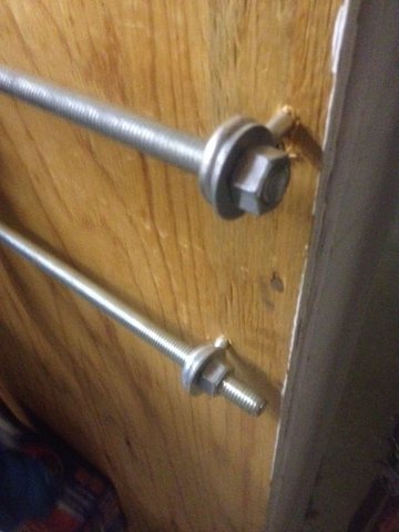

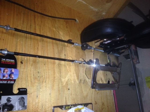

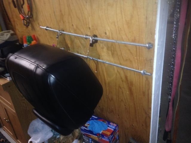

I did the DIY as well. It cost me less then 20 bucks for 2 racks. I used threaded rod, eye bolts, a couple nuts and washers. Never had a problem.

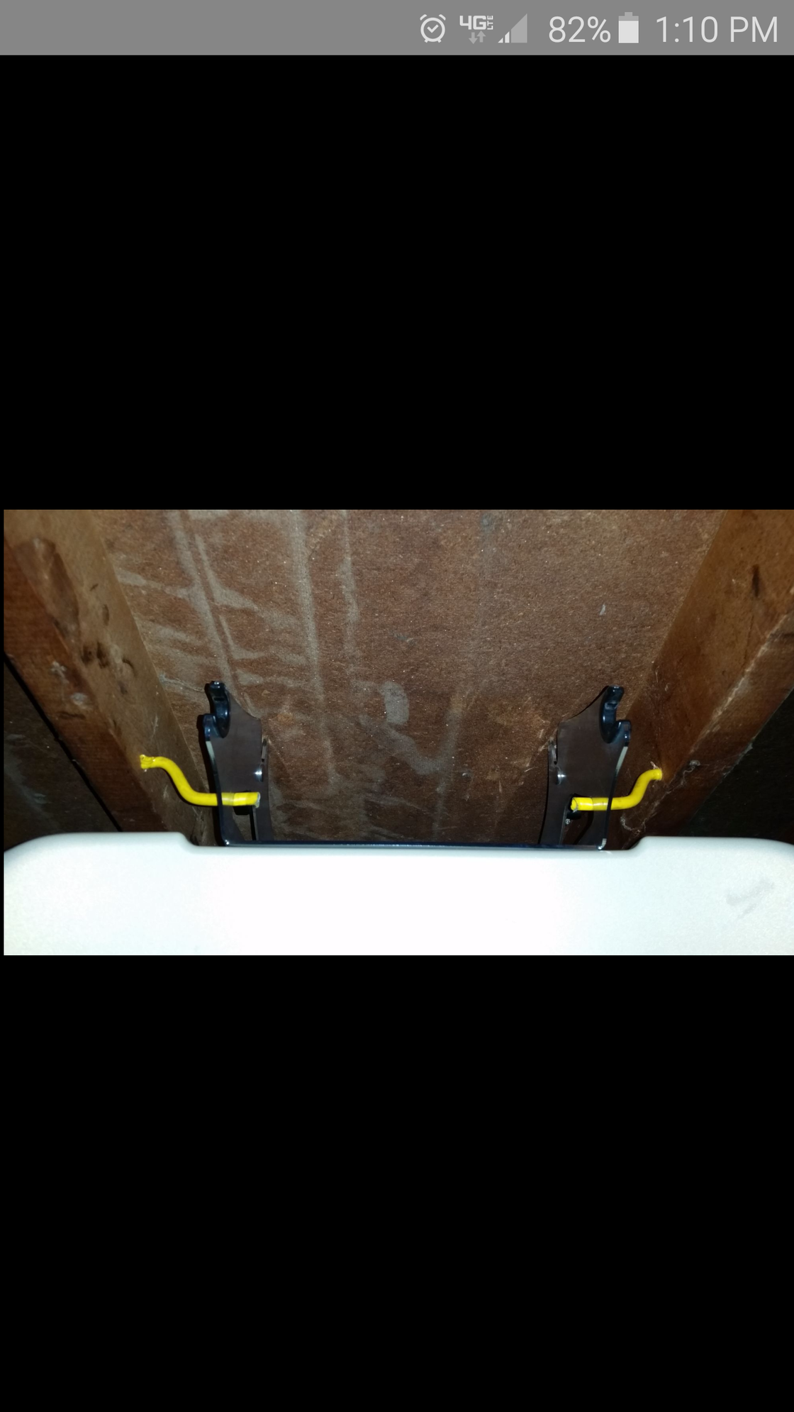

Here is one that was posted last week, I only have a picture to share not my idea but a good one. Two bike hangers cut down.
