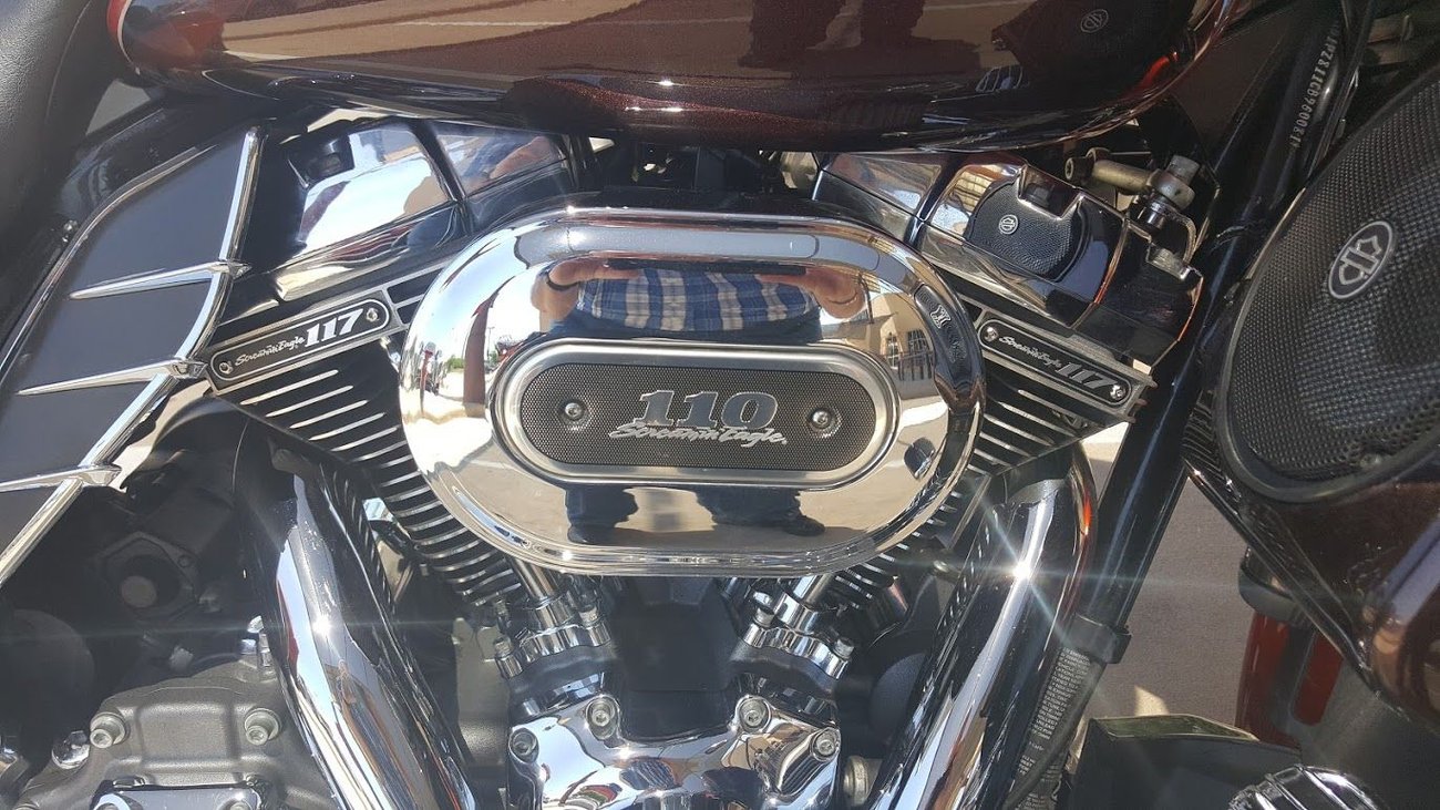

I guess my 117" Pro Race kit installed in my 2009 CVO Road Glide is not proof enough.
YB

The BIG problem with these Bolt on Kits are SOME (over half from my dealer) jugs are "out of round" from the MoCo.
Lucky for me, I bought it up to my dealership before the build. Mine was one of my dealerships first customers install and I took mine to a local guy to correct the jugs.
YB
