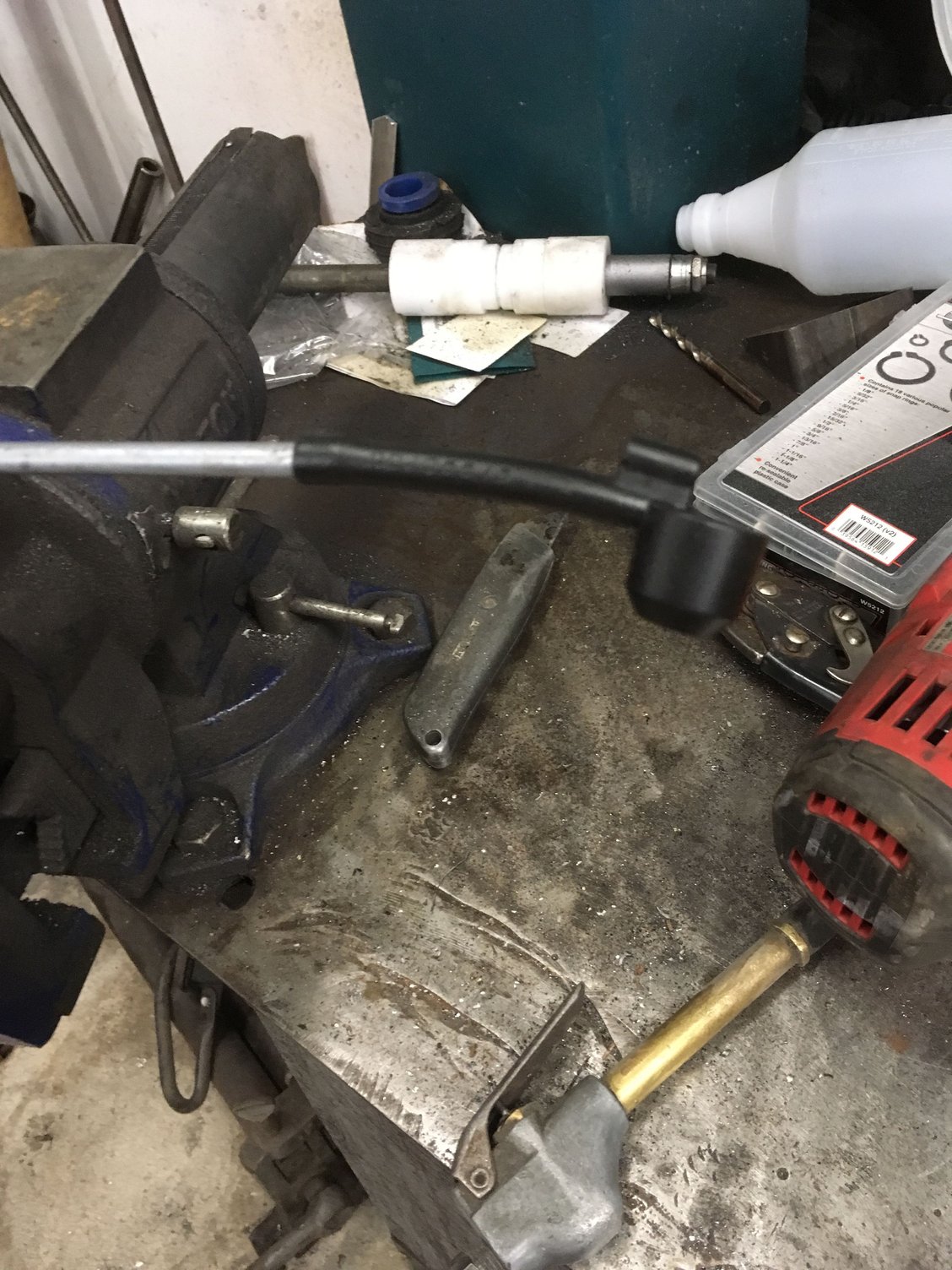

I used a very small piece of scrap 3/16 brake line
Few feet of 1/4 fuel line
A unibit drill

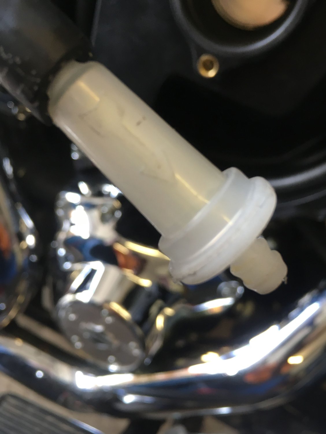

1/4 plastic T
I Also used a mower gas filter I had

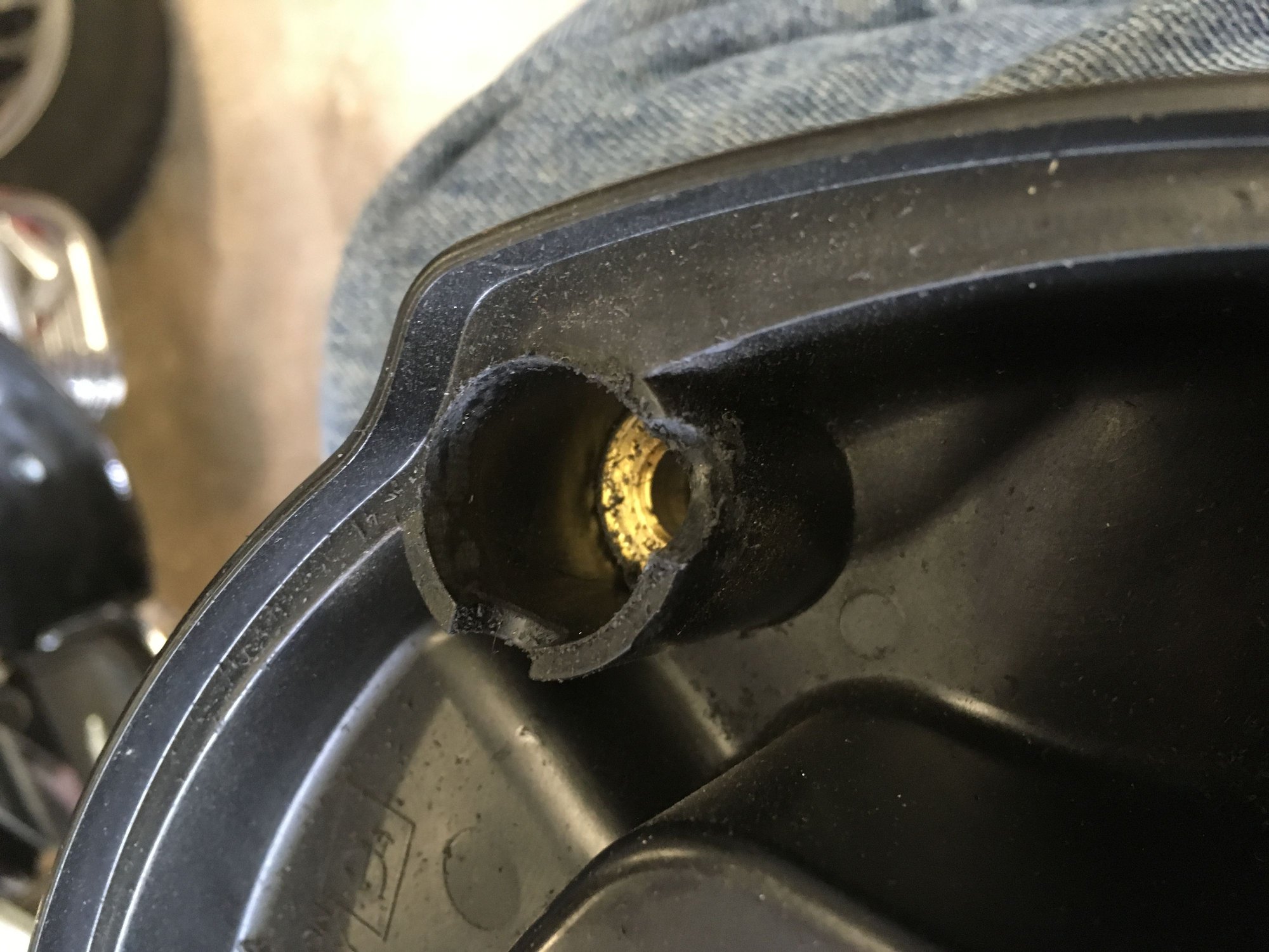

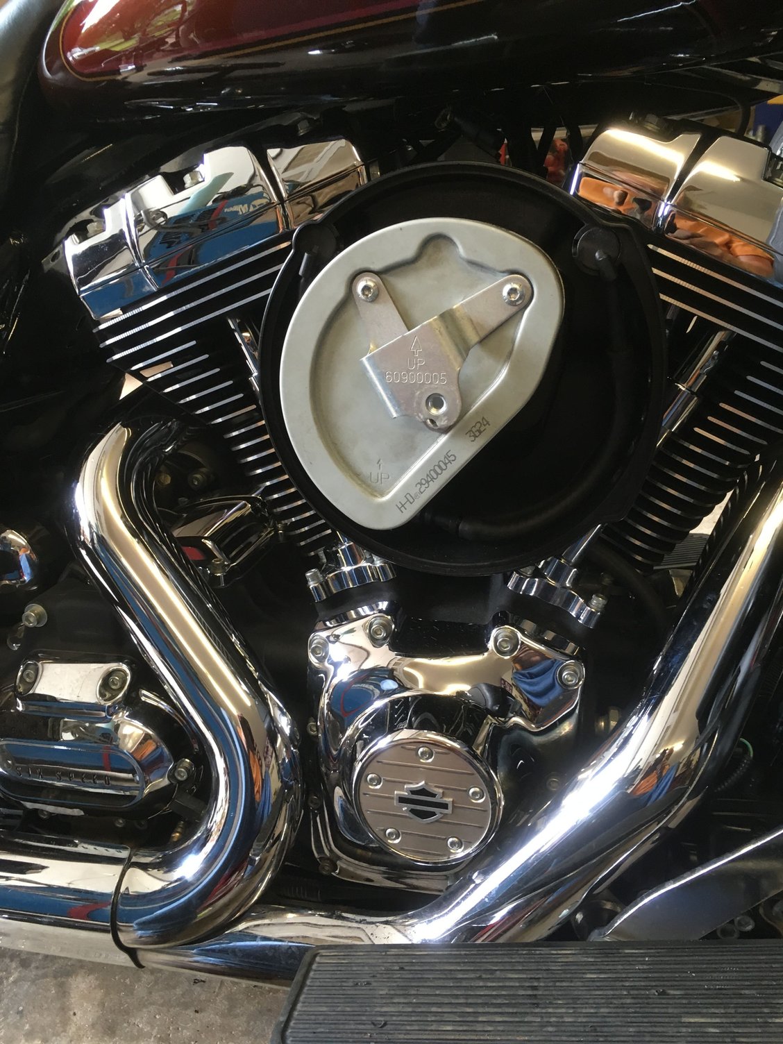

Pretty easy just notch air filter housing to let line aim down
Than push some 3/16 brake line in hose
Than just push the 1/4 line over the 3/16
Drill a hole in bottom were t is. Run line to your favorite exit spot
I run it forward and down under with the gas filter inline

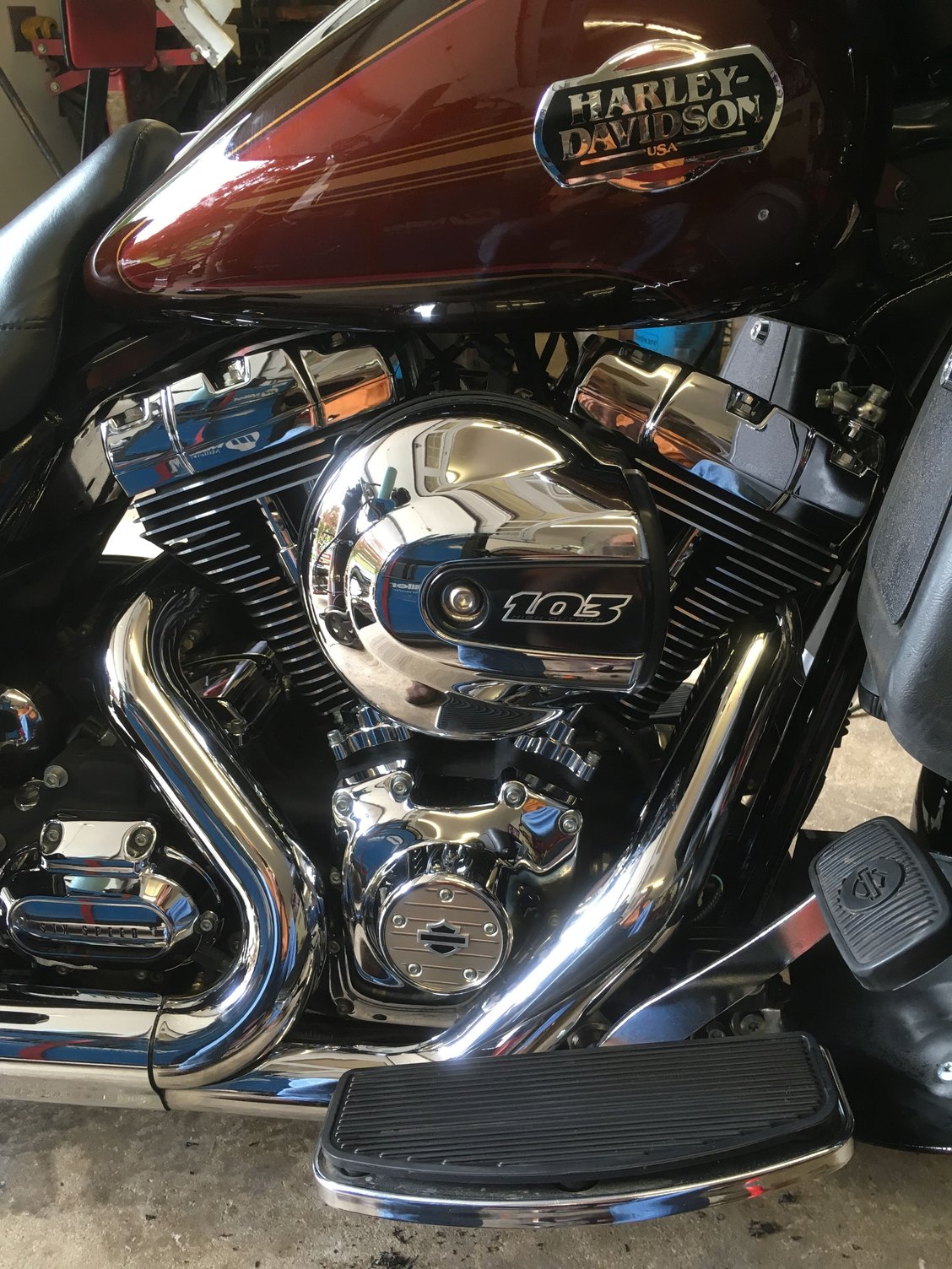

Ride it 309 miles after I did it. Nice and clean Never smelled oil all day yesterday in
85 degree heat

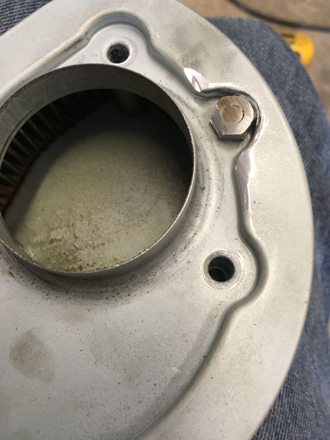

Also didn't have time to wait for silicone to
Dry for air filter hole. So pushed a 1/4 bolt in hole and put a very small tig weld on
But silicone works for 99% of the guys that do out
Use the black silicone mushroom it out on outside end
Leave it set till next day
