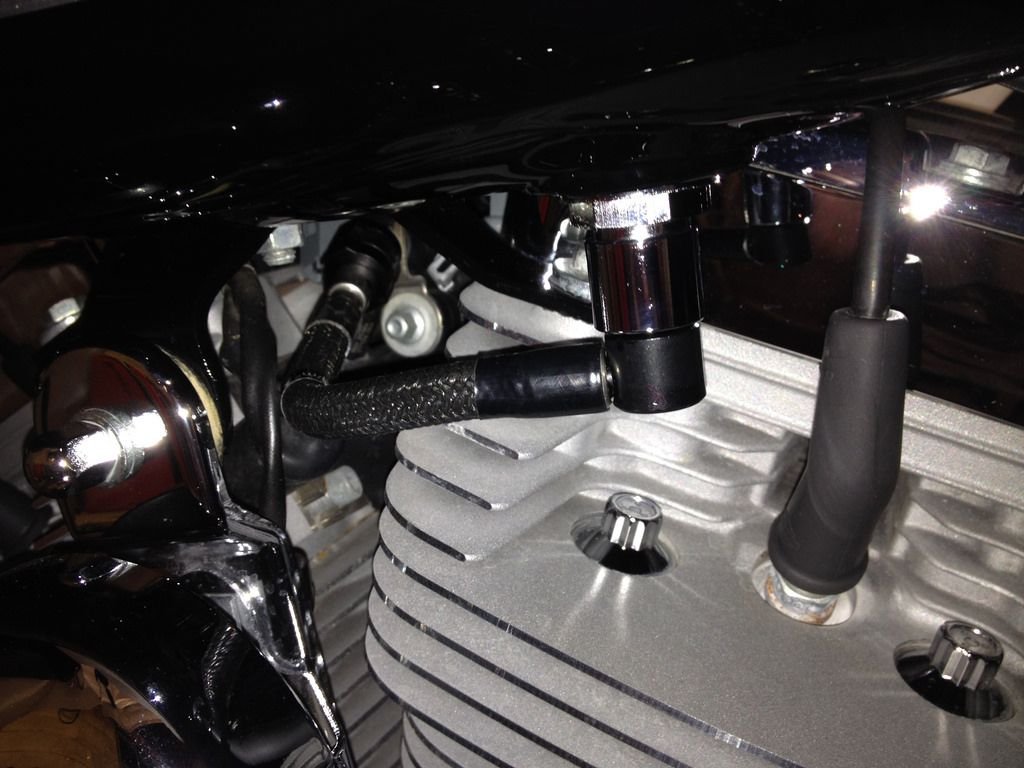

If you have the original fuel hose, from the tank quick release to the throttle body, on your '07 you probably will need to replace that also. The original hard plastic fitting that goes into the quick release can go bad causing the check valve in the quick release to shut off the fuel flow. The replacement hose from H-D looks much different and is similar in design to the later fuel hoses.
Mine shut off while accelerating in a pack of bikes and I was lucky I did not cause a mass bike crash. Took me a while to find the cause too. Also check the o-ring in the quick release when you remove the hose and verify it is not torn up. Supposedly you can replace the o-ring, probably using a small pick to remove it and push in the replacement.
Here is a photo of what goes wrong. The red circle is where the fitting has worn from the 3 retaining ***** that hold the fitting in. The depressions caused the fuel fitting to move out just far enough the check valve shut off the fuel.
Here is what the new hose looks like. It appears H-D changed the design, probably because of this problem.
Thanks for this very useful information. I have had the fuel shut off twice on my 07 Road King, but not while moving. In both cases, the bike wouldn't start. First time it went home on a flatbed, since I didn't know what was causing the problem. I replaced the fuel filter and in the process, had the quick-disconnect apart from the tank, so probably "fixed" the problem by reconnecting it. Second time, I simply disconnected and reconnected it. Didn't know that the fuel hose fitting was bad itself.
Gonna make sure to pick one up and change it!
