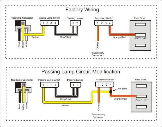

Truck Light Phase 7, the all three set.
Adjustment is critical.
Highly advise the high beam wire mod to use the passing lamps on high or low beam.
