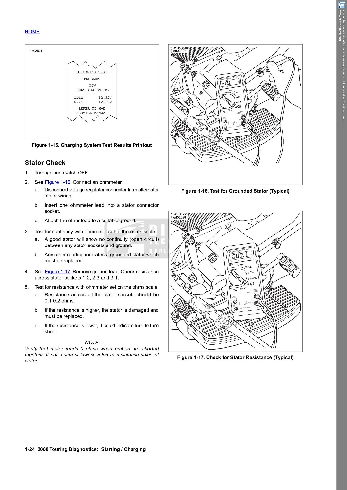

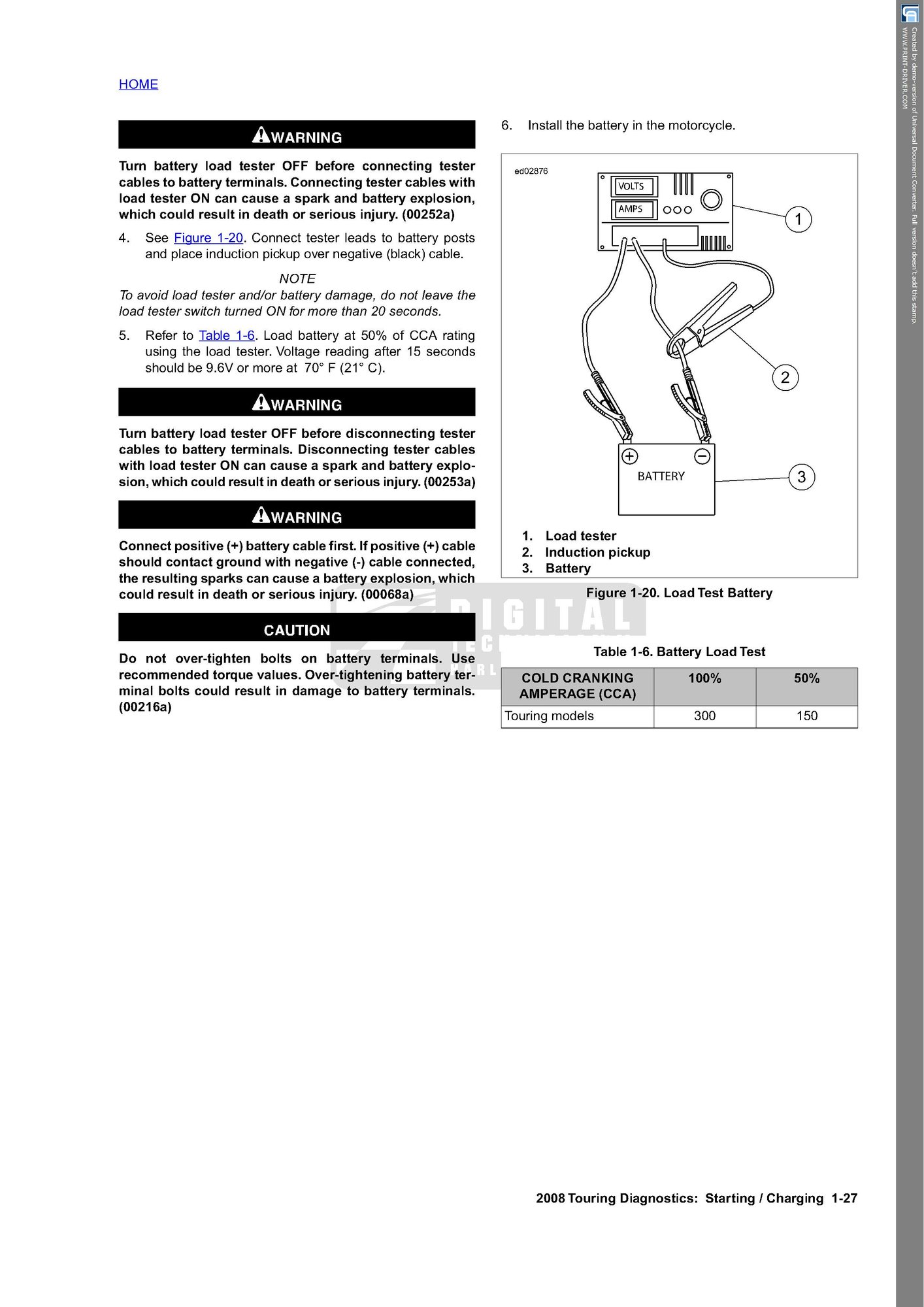

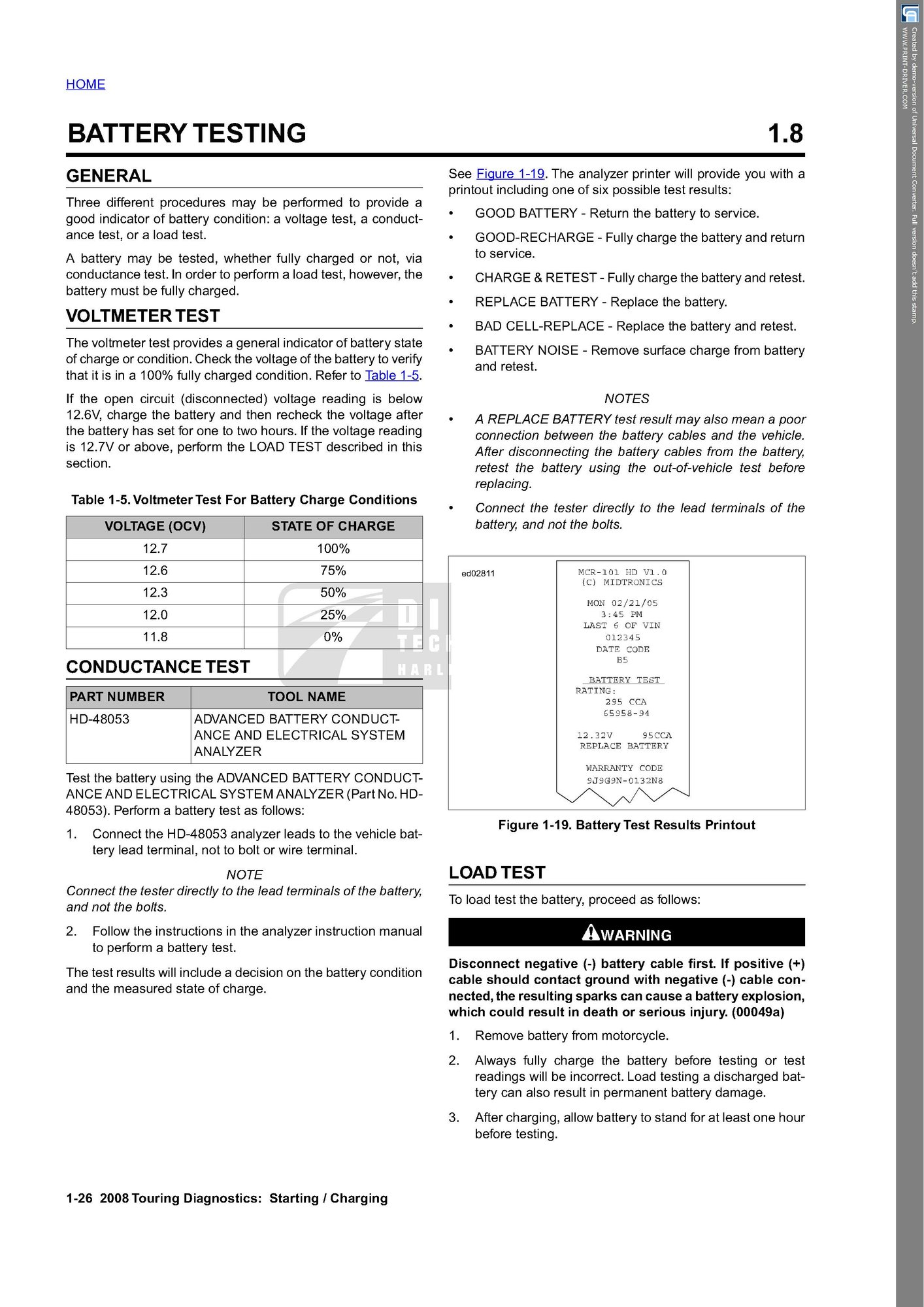

You may want to check a few more things, stator output, have the battery load tested, ground connections ...
Good Luck
