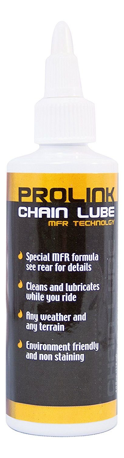

My adjuster rings became almost impossible to adjust even tho the threads on my Ohlins looked clean. I backed the adjuster rings off, cleaned and lubricated with Prolink, (chain lubricant) used on high performance road bikes. It bonds to metal surfaces, dries clean, does not build up or become tacky, and sheds dirt. My adjuster rings are smooth as butter now.
Originally Posted by SoCalHDMC
If this is the original formula Prolink Stuff, I have used it for years on chain driven motorcycles and machinery. Fantastic product. FWIW, I am fairly **** when it comes to keeping my equipment clean, including threaded shock bodies, regardless of application. I also adjust the preload each time I ride two up, and back it off at the end of each trip for my solo jaunts. No issues.
This stuff?

Prolink seems like a good choice.

hbsoldier Thats the stuff.

Kool, just ordered some on Amazon, thanx.

Like CSS states, that’s it. Used to be a little difficult to come by, was only in select motorcycle and sporting goods stores. Leave it to Amazon!!
