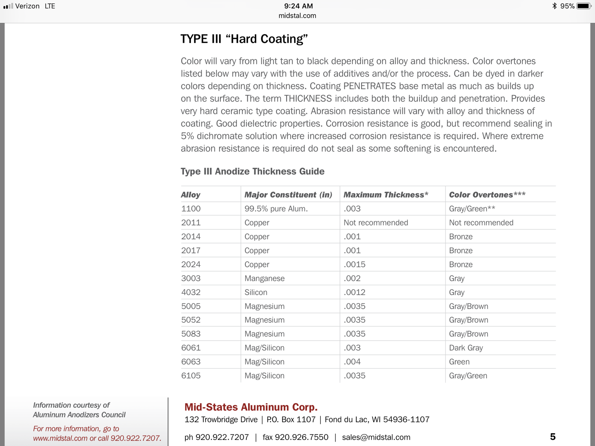

We both show up and place a legal wager , one with a written contract. Show up, sign the legal contract and Q.C. Metallurgical Inc writes a report on if the aluminum Ohlins shock are hard anodized or not. This concept is fairly easy to understand. I already have a legal and binding enforceable contract waiting on you. There is nothing more to talk about. Prove your point or not.

Just tossing this out there -
https://www.wrisco.com/clear-anodized-aluminum/
From the link -
Clear anodized aluminum refers to aluminum that has gone through the clear anodized process. However, the clear anodization of aluminum does not literally mean that the aluminum becomes clear but rather refers to the fact that the aluminum undergoes an undyed anodization process. The actual appearance of clear anodized aluminum ranges from an extremely light shade of gray to a dark, richer color. The thicker the coating is, the darker the color will also be. The clear anodized aluminum process involves washing the metal with specific chemicals for the process. More specifically, the process of anodization involves aluminum being submerged into solvent baths where chemicals like sodium hydroxide, ammonium bifluoride, and other acids may be used. To sum up, the clear anodized aluminum ends up having a heavier oxide layer as a result.
I'm not an expert, just an enthusiast. My understanding is you can "clear" anodize aluminum. From the above I gleaned that it simply means a thinner coating. I could be wrong.
Since I last posted on this thread I have gone to a different shock manufacturer. I will say that I prefer the larger adjustment collar to the thin ring on Ohlins. That wouldn't be a deal breaker for me, but I agree that from a consumer standpoint, it could be improved. From an engineering standpoint? Couldn't say - I'm not an engineer.

From the link -
Color varies depending on material..we can dye it darker, but we can’t go lighter. It’s a chemical process that reacts with the material base elements

Either show up and prove your case or not. You can keep on putting out erroneous information all day long but in the end the proof is doing it. Bring whatever you want and I will match it. If you are so sure that Ohlins does not Hard Anodize their shocks including the inside bore than you would just accept this Florida Legal wager on Performance. Either show up and prove your case or not!
