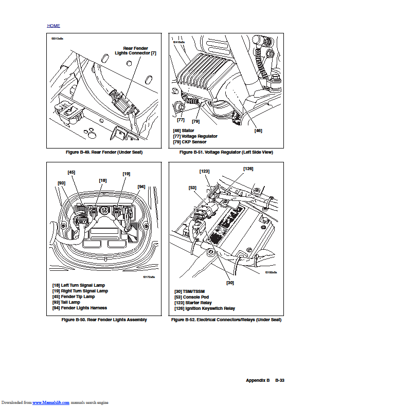

Have you checked where the rear fender lights connector under the seat at the front of the rear fender? With a test light you should be able to check for both turn signals, run & brake lights. It also looks like there are more connectors in the rear tail light base that attaches to the fender. Remove the tail light lens and check there also.

Kind surprised no one has said to check the wiring on the underside of the rear fender. I've read several instances lately of that wiring being damaged by the rear tire and causing all sorts of odd problems.

Unplug your run turn brake module first and see if issue goes away. A short in the fender tipp light can cause this issue also. Unplug and recheck.
