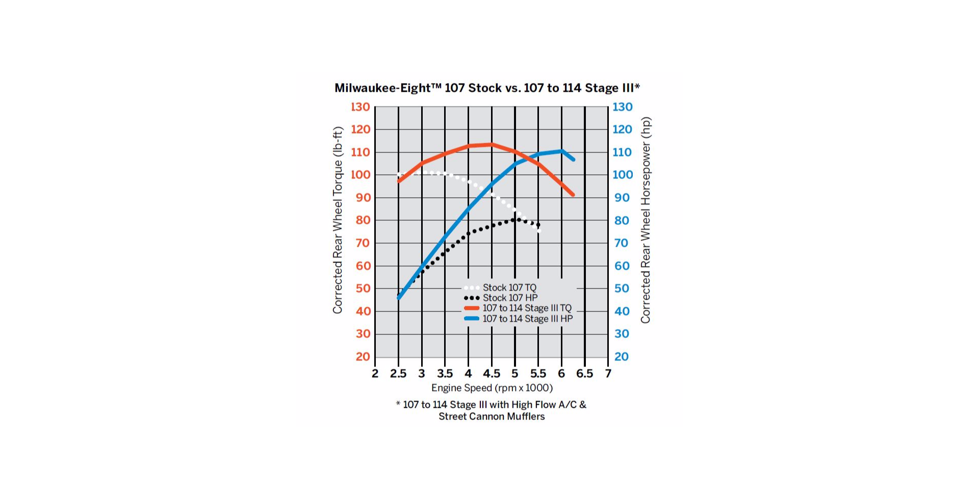

Here's the MoCo's "Corrected for rear wheel" dyno charts from the P&A catalog for both the 107 and the 114. Stock engines are dead after 4000 rpms. Probably due to the cam designed to meet emission standards. But the base engine should be a terrific platform to make real hp with cam, larger TB, larger injectors, 2:1 exhaust and tuning upgrades. I can see the aftermarket suppliers getting these 4 valve heads to produce in excess of 130hp/130ft-lbs without breaking a sweat.
107 to 114 upgrade kit dyno

..... i look at those comparison HP/TQ charts above, and it appears the 104-114 kit makes more HP than the 114-117 does
......... that doesn't say much for that 117 kit

114 cubic inches and can't bust a 100 horsepower at the rear wheel. Pitiful.
