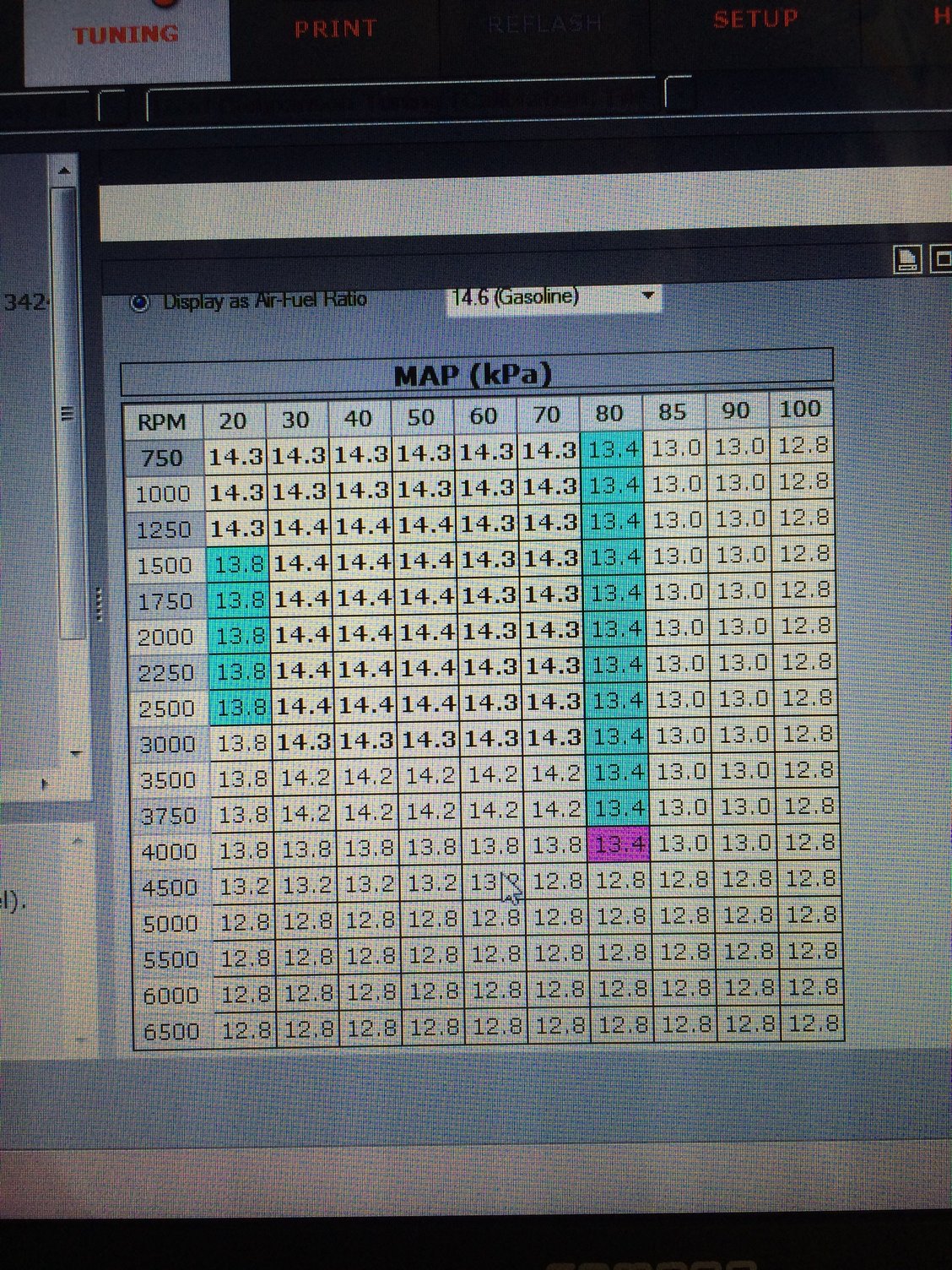

Originally Posted by GriffinDenim13FLHX
What are your top two rows from closed idle all the way over to say 70% throttle?
In the AFR.

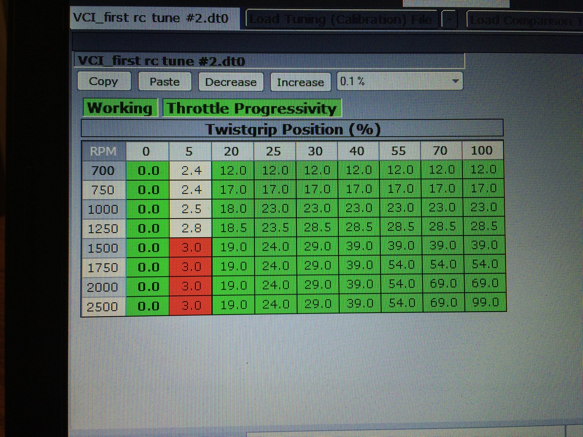

Should these red cells be red?
Yes, that is how mine are as well.
The progressiveness is not going to help you with your popping. That is for how much of a delay on your throttle body opening and closing compared to the throttle position.

Got it taken care of and posting this for anyone who is looking for a fix. I'm not saying it's the right or wrong way just how I fixed the popping on decel on my bike.
Lowered AFR table in the first column form 750-3000rpm to 13.2 and progressively added .2 to .4 to the VE tables in the first column in the same rpm range.
