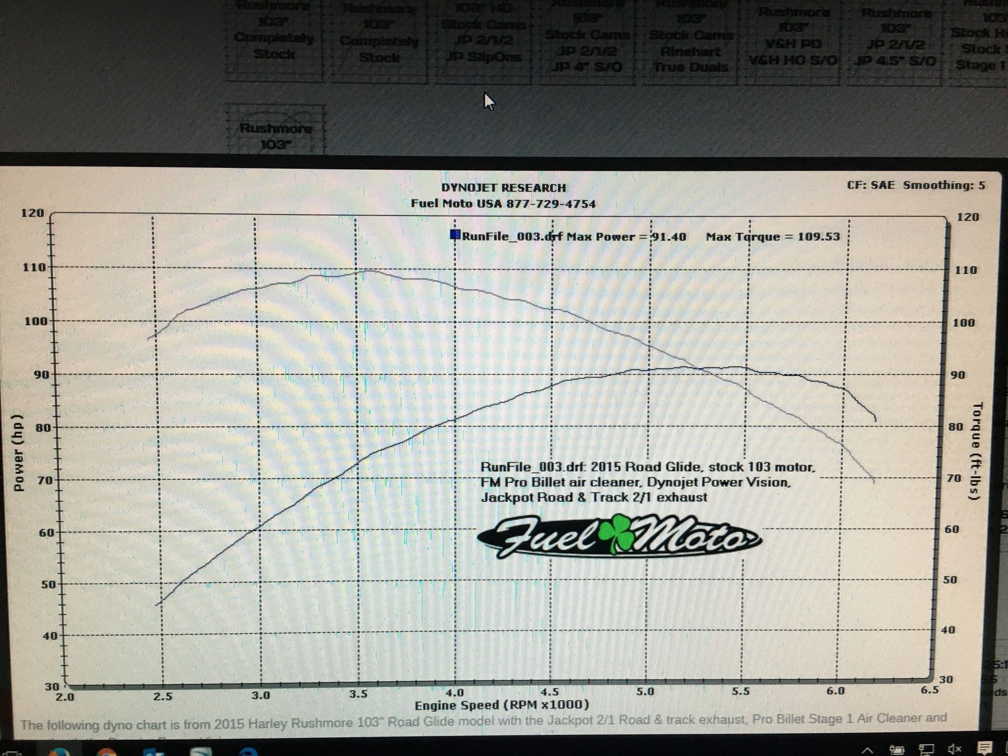

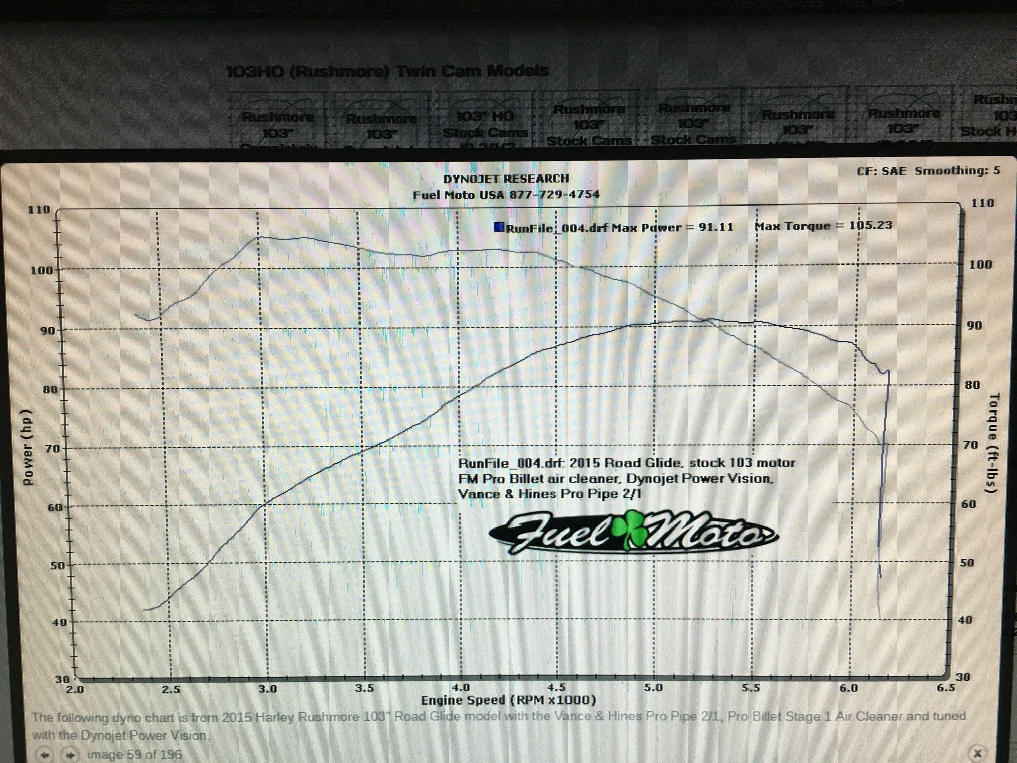

These numbers are so close it doesn't help make the decision. Although the FM will more than likely be the better pipe to add onto the build with.

In those charts, the Jackpot looks better than the V&H which has a slight dip at 3.5-4.0K. Also, I think I recall seeing some dyno charts where the Dragula 2 compared well with the Jackpot with regard to shape of the curves (smoother, no dip) and Ft-lbs/HP numbers.
Wish I knew how to really read these charts. I'm just going off the overall numbers for HP and torque.
