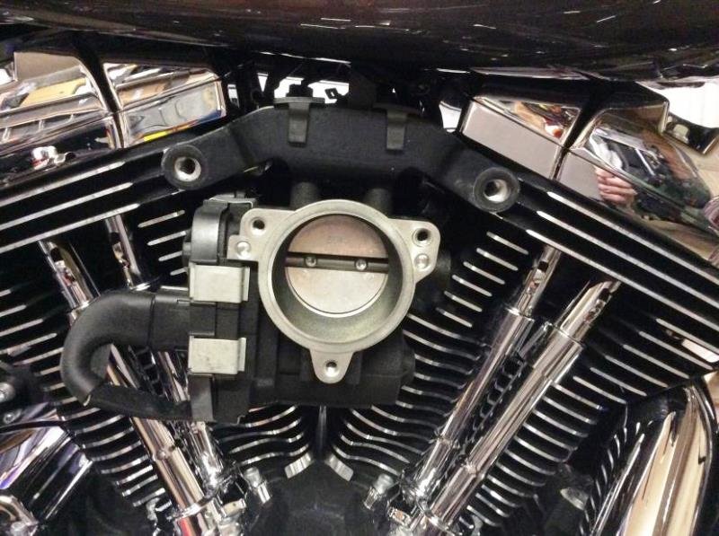

I'm changing the air cleaner on a 2014 Ultra Limited from a Screamin' Eagle unit to a Big Sucker (with the OEM 103 cover).
The problem is that the SE requires the Throttle Body Support Bracket to be removed and the Big Sucker needs to have it in place, so that the breather bolts are the proper length. Unfortunately, the Bracket didn't come with the bike.
Can washers be used to take-up the gap left by the Bracket or do I need to Bracket for additional support?
Does anyone have one of these laying around (Harley, Kuryakyn, etc.) that they could part with at a reasonable price?
Thanks and enjoy the rest of your weekend!

You need the bracket to support the module. Im not familiar with the big sucker, what backing plate does it use? If its backing plate is not designed to also support the Module, then you need the bracket to prevent the module from becoming upset and sucking air at the manifold.

that's the same style backing plate I have , SE model and it requires the removal of the support bracket. I may have one laying around. I will pm you if I do.

You remove the bracket and discard it when you install this .

Installation of the Screamin' Eagle Extreme Ventilator air cleaner assembly requires that the support bracket be removed.
Installation of the Big Sucker air cleaner assembly requires the support bracket to remain.
This may be different for earlier models, but this is what's required for the 2014-2016 Rushmore Touring Models.
