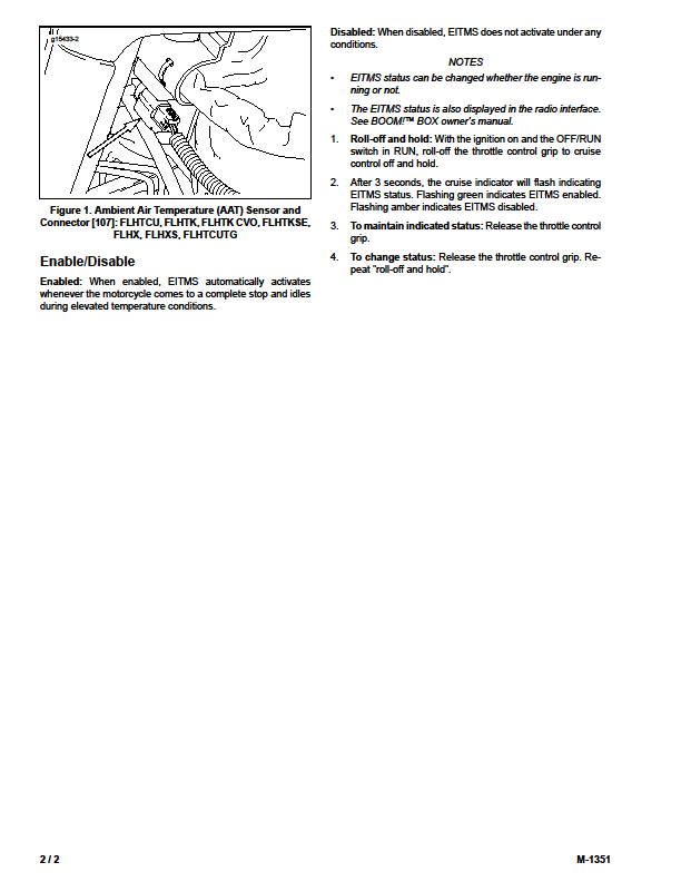

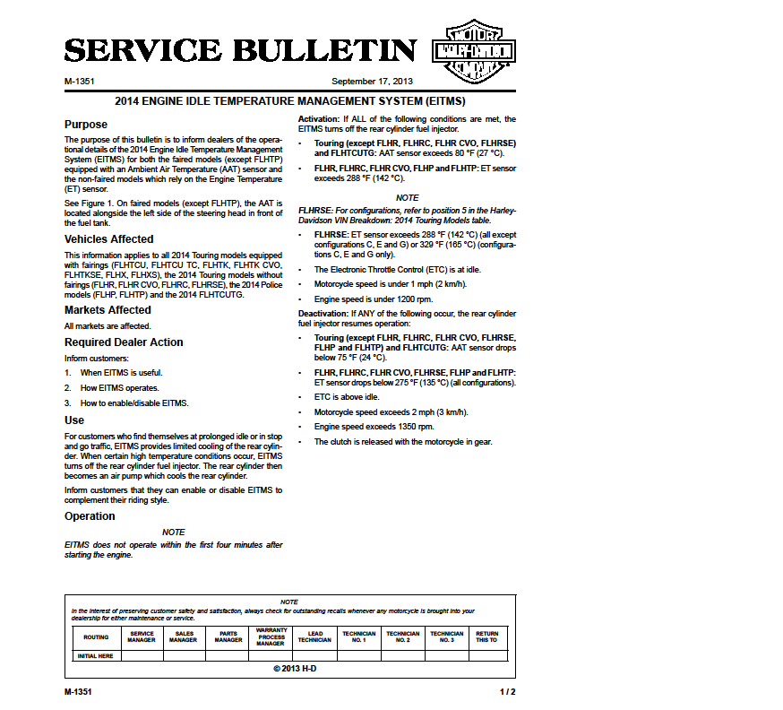

There are three things that CAN turn on the EITMS system.
Ambient Air Temperature
Engine Temperature
Coolant Temperature
There is a timer in the ECM that waits until the engine has been running for a period of time and then any one of the three items can turn the system on if the bike is equipped with it. The Ambient air temperature is really a joke as the air can be hot and the engine cool and it still turns on.

Originally Posted by surfrat2
I have a 2015 RGS that I've noticed the EITMS activates when the ambient temp is under 80 degrees. It activated yesterday when the temp was 61 degrees. According to the manual I thought one of the parameters that HAS to be met is an ambient temp exceeding 80 degrees. Anyone else with this issue or any ideas? I know I can just turn it off but I'd rather know if there's a problem.
I have a '14 Limited and the EITMS works exactly as described in Service Bulletin M1351. The EITMS has never gone Active when the Air Temp was less than 81* as indicated on the Vehicle Status screen. I do know that if a heat source is placed near the AAT sensor it can 'fool' the EITMS that the air temp is high and this will activate the EITMS
