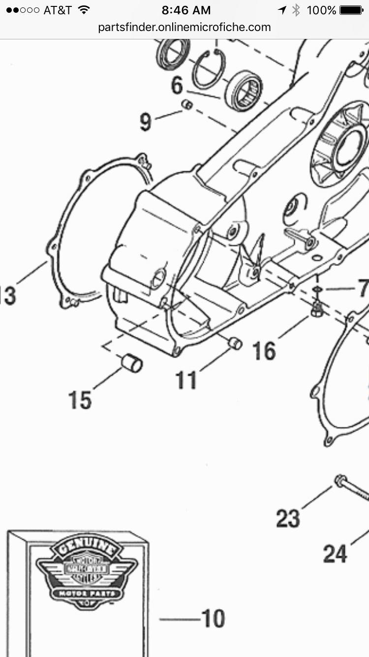

What I have noticed lately (not related to the Pingel) is it seems the primary case has more slop to it where the shaft goes thru, like it's wearing out (getting larger). It would seem to me that there should be some type of brass sleeve in there so the aluminum case doesn't wear.

Posts: 157,462
Likes: 57,017
"Hunter" ... There is a bushing in there and it is replaceable.

Originally Posted by Bowhunter61
I've had Pingel in the bike for about 40k miles. Shot a grease during fluid changes and it keeps it moving freely.
Yep there is a bushing. Number 15
HD part # 42642-00
Damn....the things you learn on here. Thanks Larry!!
Looks like I need to replace that. Anyone know how long that bushing is? Looks too short in the diagram Tinman posted to support the whole shaft.
