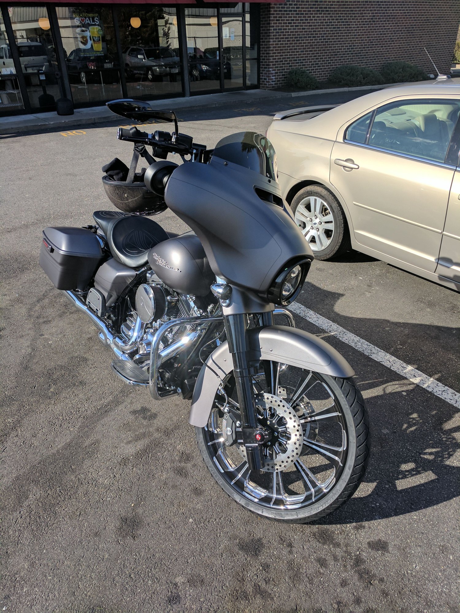

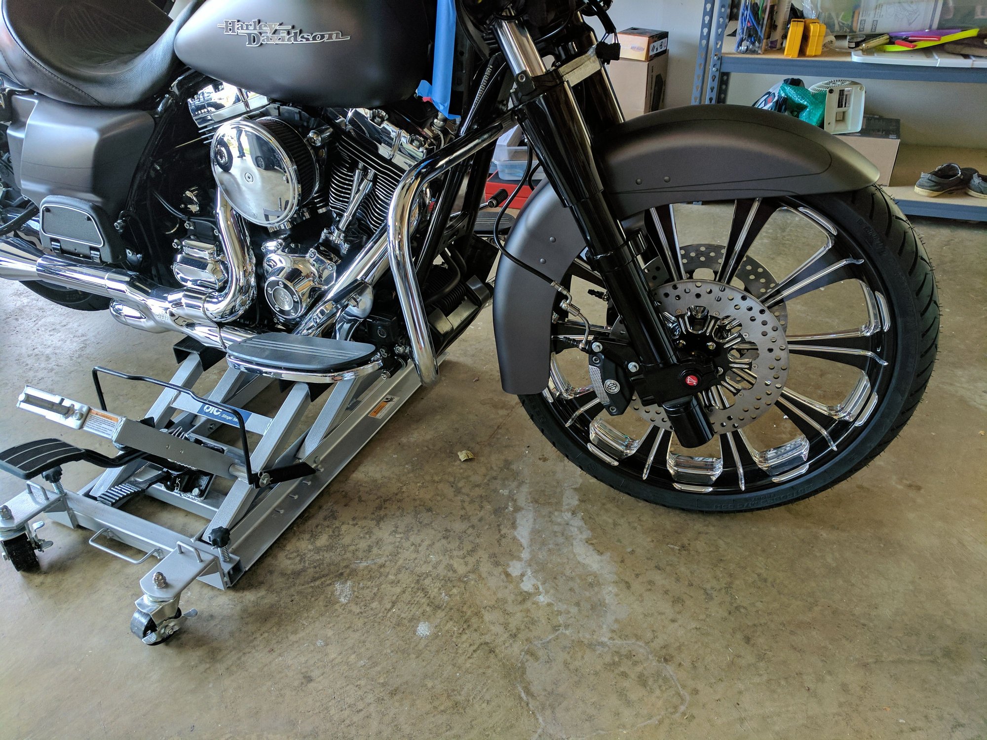

It was flawless, easy to install and looks awesome. Had a buddy lend some extra hands, highly recommended. Did not take the time to do a build thread, but here are some pictures and the build list.
- 23" PM Revel, matching rotors, Metzler tire
- Battistini Leading Axle All Black, Hidden Axle
- Replaced brake pads to bed in with the new rotors, added the Battistini brake line extension at the calipers. Probably could have done without the extension and did not need the supplied alignment shims. Everything matched up perfectly. Bled the front brakes.
- Legend Axeo -1"
- Harley black cowbells
- Harley Burst grips
- Harley Illuminated Bar controls
- Road 6 Customs Holey Roller Bagger bars, 13"
- Kuryakyn Trigger Levers
- Kuryakyn Scythe Mirrors
- Heat Demon Grip Warmers
Only things left on the bench are Kuryakyn Mesh Master Cylinder covers and INNOV K1 system. Still need to powder coat. Weather has been good so I didn't want to miss another riding day.
minor challenges -
- Legend Axeo. Alignment cups would not go through the fork to the bottom on my 2016. Had to separate the forks again and put the alignment cups in, then reassemble again. Instructions said it was not needed to separate them, but apparently you do.
- Mounting the fender took some patience and extra hands to get it mounted.
- Made two support calls during the installation. Rikki Battistini called back after an hour, but I had figured it out myself 5 minutes after the call. The other was to Legend for that cup issue. Never heard back.

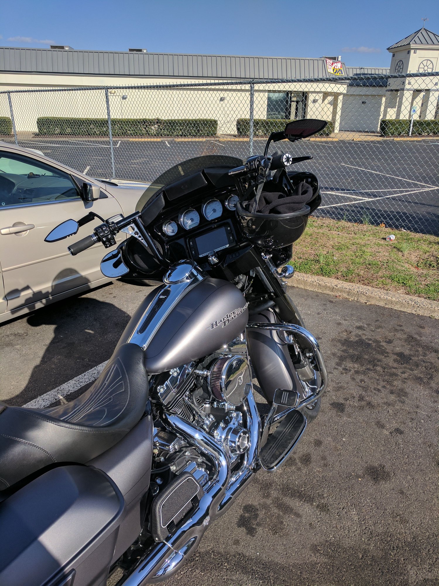

The ride is awesome, all clearances are perfect. The bars provide so much more control at low speeds and the big wheel adds a bit of weight when turning into corners. Took a minute to fall in love with the handling. Legend felt nice on some patchy pot holed asphalt areas. Everyone loves the look, as do I. Not a single issue or DTC code. This was well worth it and I feel much better having done everything myself. I know everything has loctite and is torqued proper. The angle on the jiffy stand needs to be addressed and I had to loose my center stand.

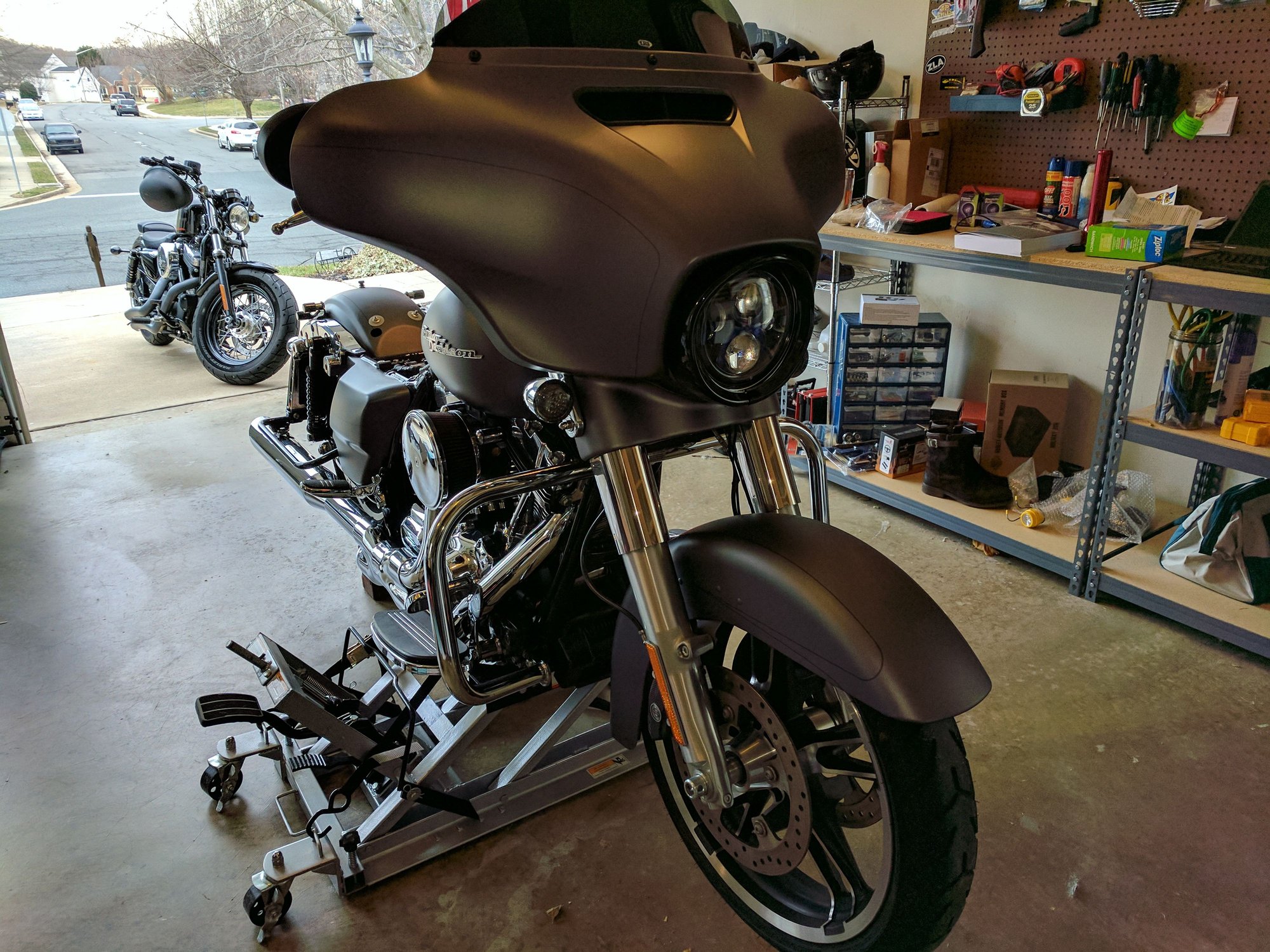

Before
