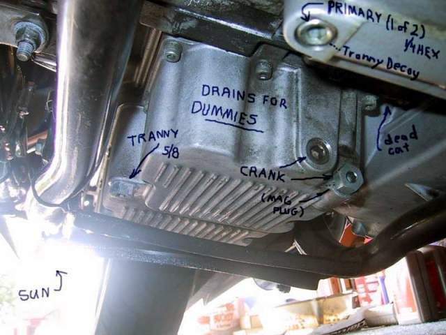

actually, this OP pulled a plug from the rt side crankcase...ain;t never seen that before- see pic.
usually it's the one next to the oil drain- which has a different torque spec
and oil pan busted is way cheaper than crankcase busted

Remember this classic? Love the sun and dead cat
