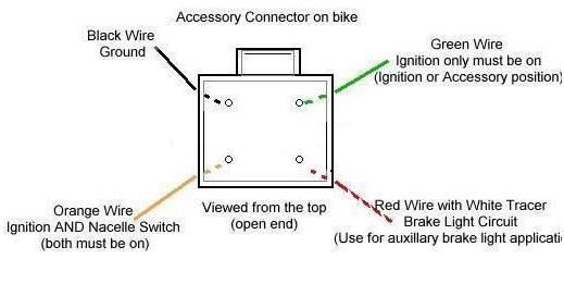

Originally Posted by mastergunnera8
I was thinking of the more recent switch kit..is there a part number for the 2013 kit?
The AUX switch is on the pre 14 bikes when you buy it. There is no kit.

You should be able to get the parts to make the plug from the dealer. HD also makes a Y splitter if you want to hook up more than one component.
