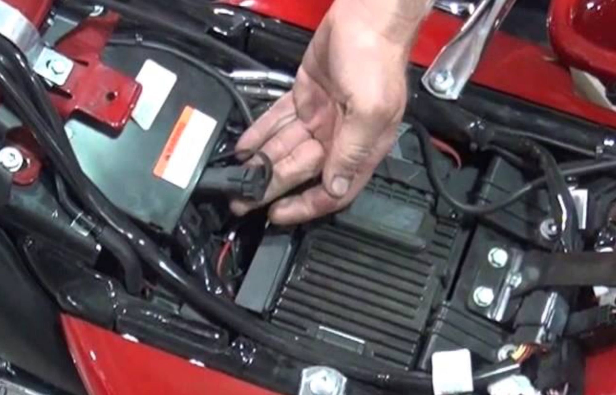

Old Mar 21, 2017 | 08:15 PM
davidwruth's Avatar
davidwruth
Joined: Jul 2011
Posts: 2,824
Likes: 153
From: Street, Md.
Should look something like this
