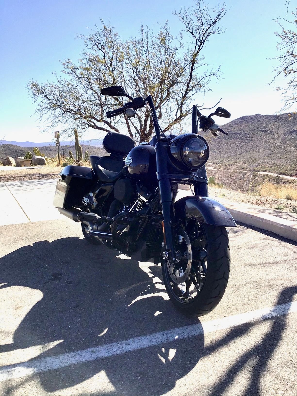

I would suggest going with 14". I'm 6'1" and road with 12" bars for nearly a year, but just never got fully comfortable with them. The 14" bars, HD Fused, were perfect and I confirmed this recently when I picked a new to me 2015 Breakout with 14" bars already on it. Naturally, your height will play a big factor in your choice. I'm longer in the legs than body and narrow across the chest (42) so I've always gone for narrow bars that are between 31-33" wide. I had 12" Apes on my 07 Road King that were 36" wide and trying to do a tight turn with them bars was always a task! Another factor to consider is your seat, if you're planning on changing your seat or have any seat work in the near future then you do that first because changing your seat will affect your ride stance. I've learned this the hard way, but it was with choosing a windshield, I got a windshield then later had my seat re-worked that dropped me by an inch and that screwed up my view with the windshield. Handlebars are the same when it comes to picking some out. Another thing you could do is get some type of flexible tubular material and mock up the handlebars you want and test "fit" them to your bike to get a better idea of how they might feel. When I worked in communications tower repair I would get a piece of flexible waveguide and make mock handlebars for my Street Glide and later for my RKS. There's a lot of variables that go into changing out your handlebars and it's good that you're getting on the forum to explore what to consider. I mean when all said and done you're looking easily spending $400-$700 swapping out handlebars so you certainly want to make sure you get it right the first time around!
My RKS with 12" bars
