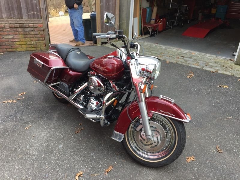

oh, and here's a picture of my "new to me 2002 Road King". Only 2800 miles. Long story short getting it from a club member who picked it up from (believe it or not) an undertaker who took it in on trade for services from the original owner. Sat in his garage for the last 8 years and rode it up and down the street now and then just to keep the fluids moving. Rest of the time he had it off the ground on a lift. Only problem with the bike was rotted tires, which have since been replaced. Clean, shinny, no dents or scratches
anywhere.
