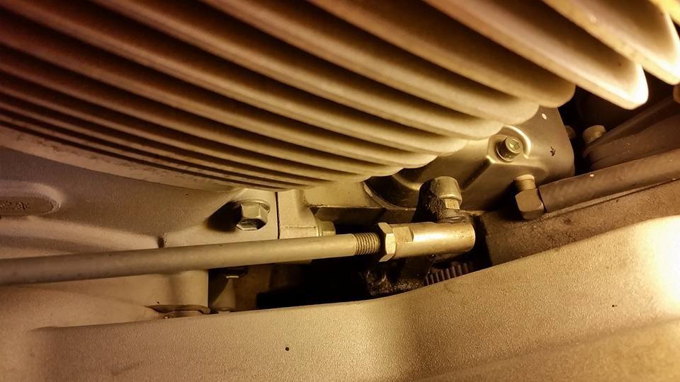

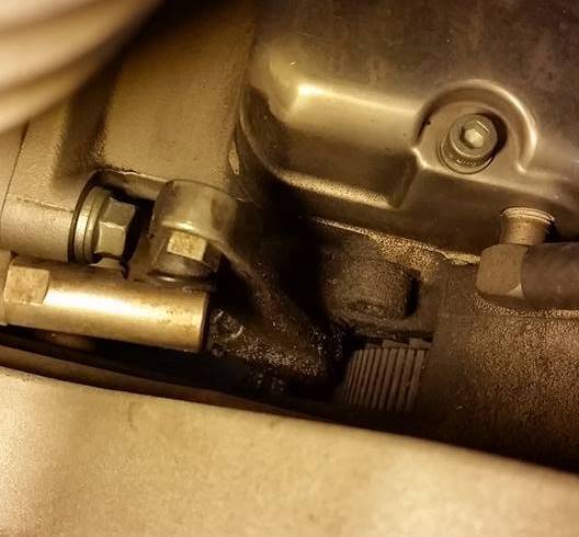

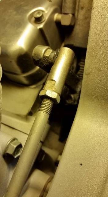

2002 FLHT with 20,040 miles. Less than 3,000 of those miles are mine. Seems like a lot of oil and grease down there. Does that look like a bad shift shaft seal?

That would be my first thought

That's the way my 02 RKC looked when the shift shaft seal leaked. I ran Red Line trans. fluid, so the red gave it away.

Yep. My bike has a bit of weeping there, too.
