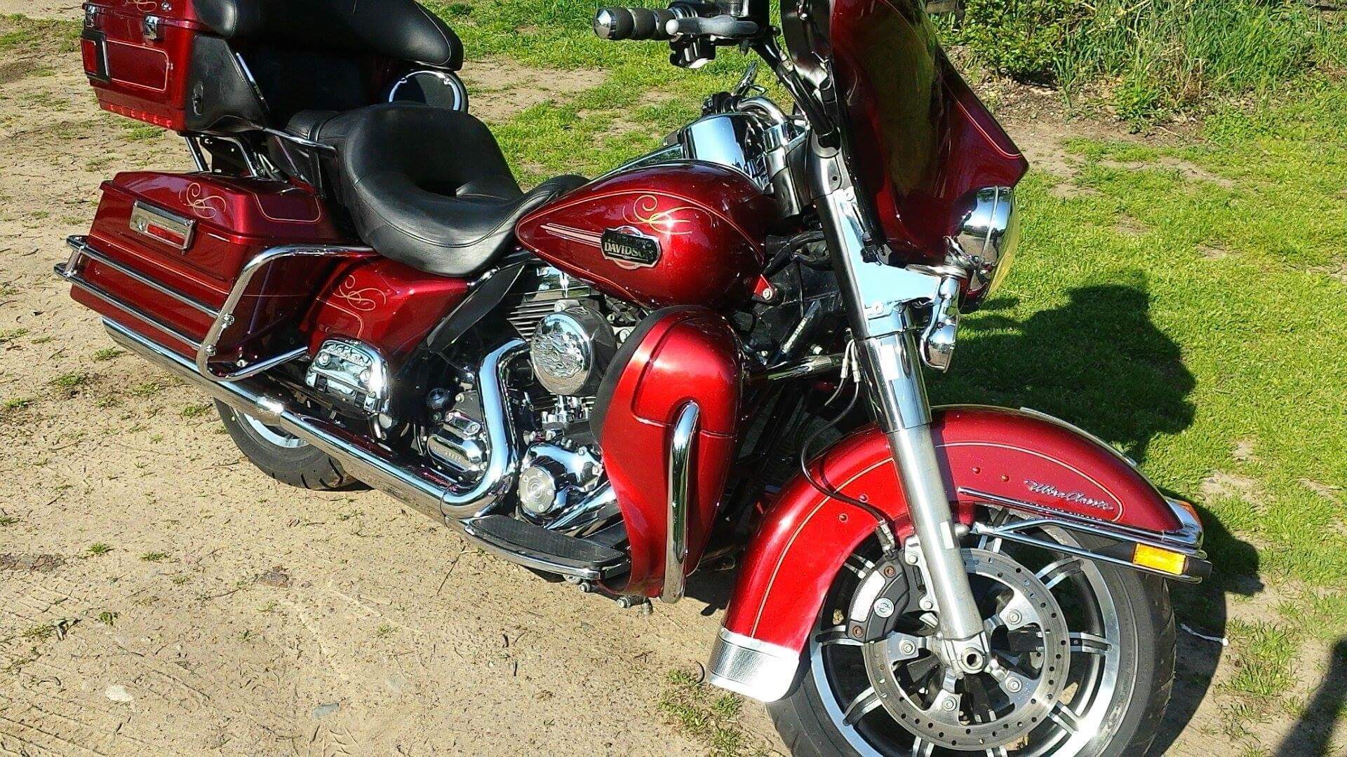

Thanks eveyone. Wheels worked great and look awsome.
pics please !!!
