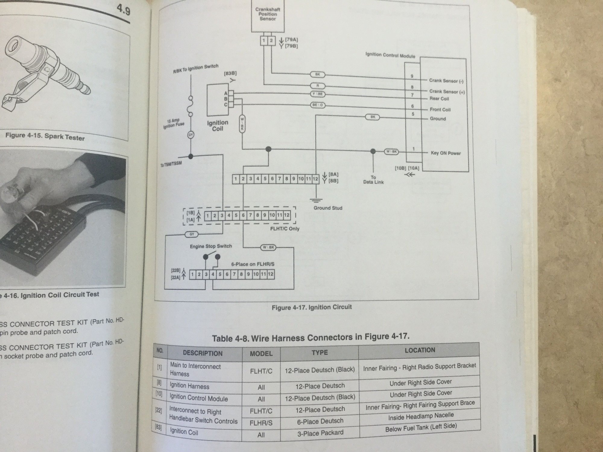

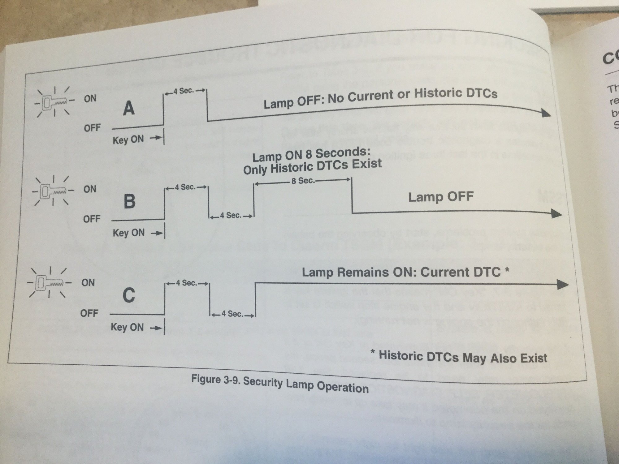

Old May 22, 2017 | 08:50 PM

Thanks for the info, keep it coming, and that chart looks like it might help, hopefully something comes of it. A friend trailered the bike back to CT closer to home so hopefully I can look at it soon.
