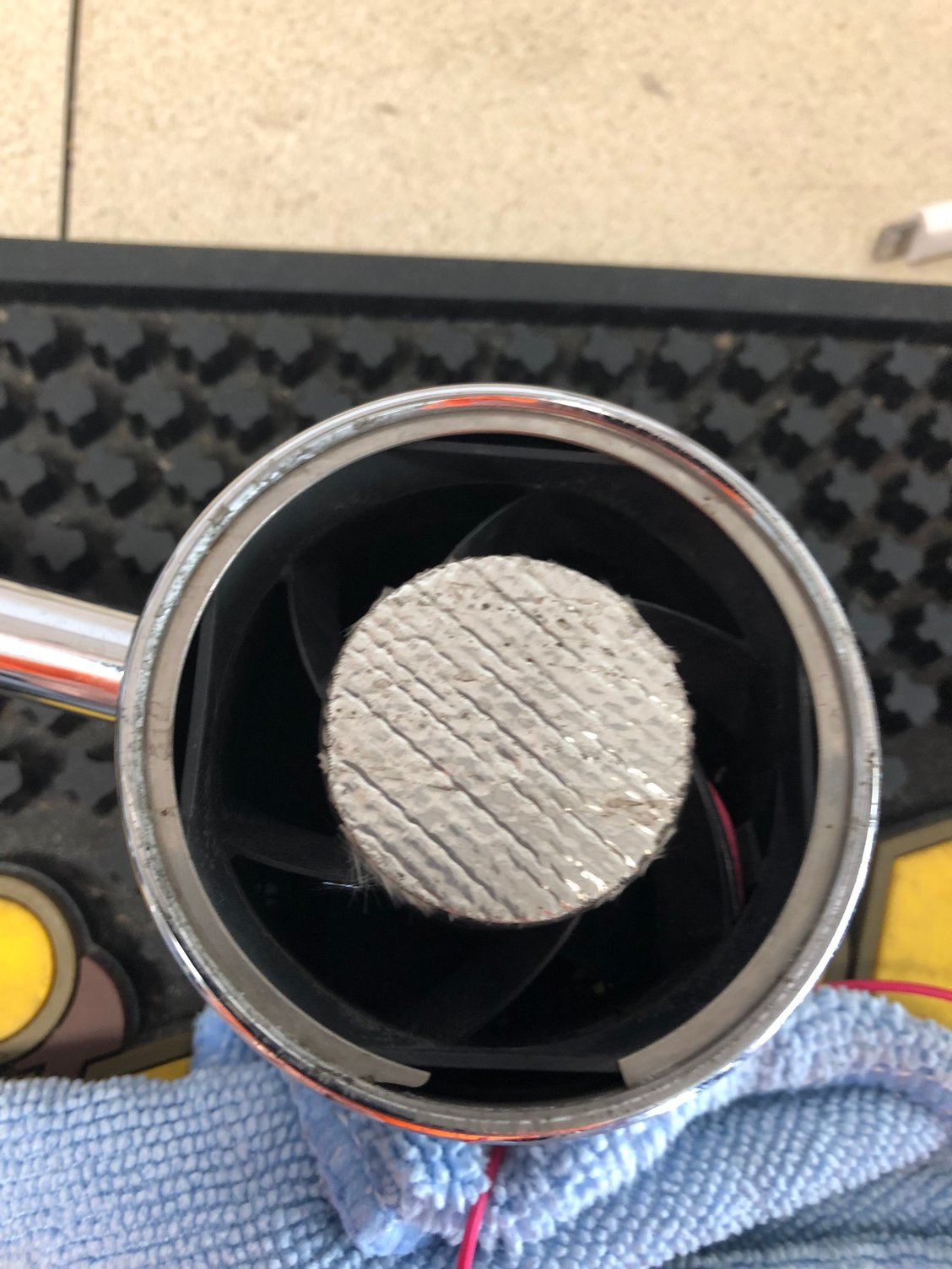

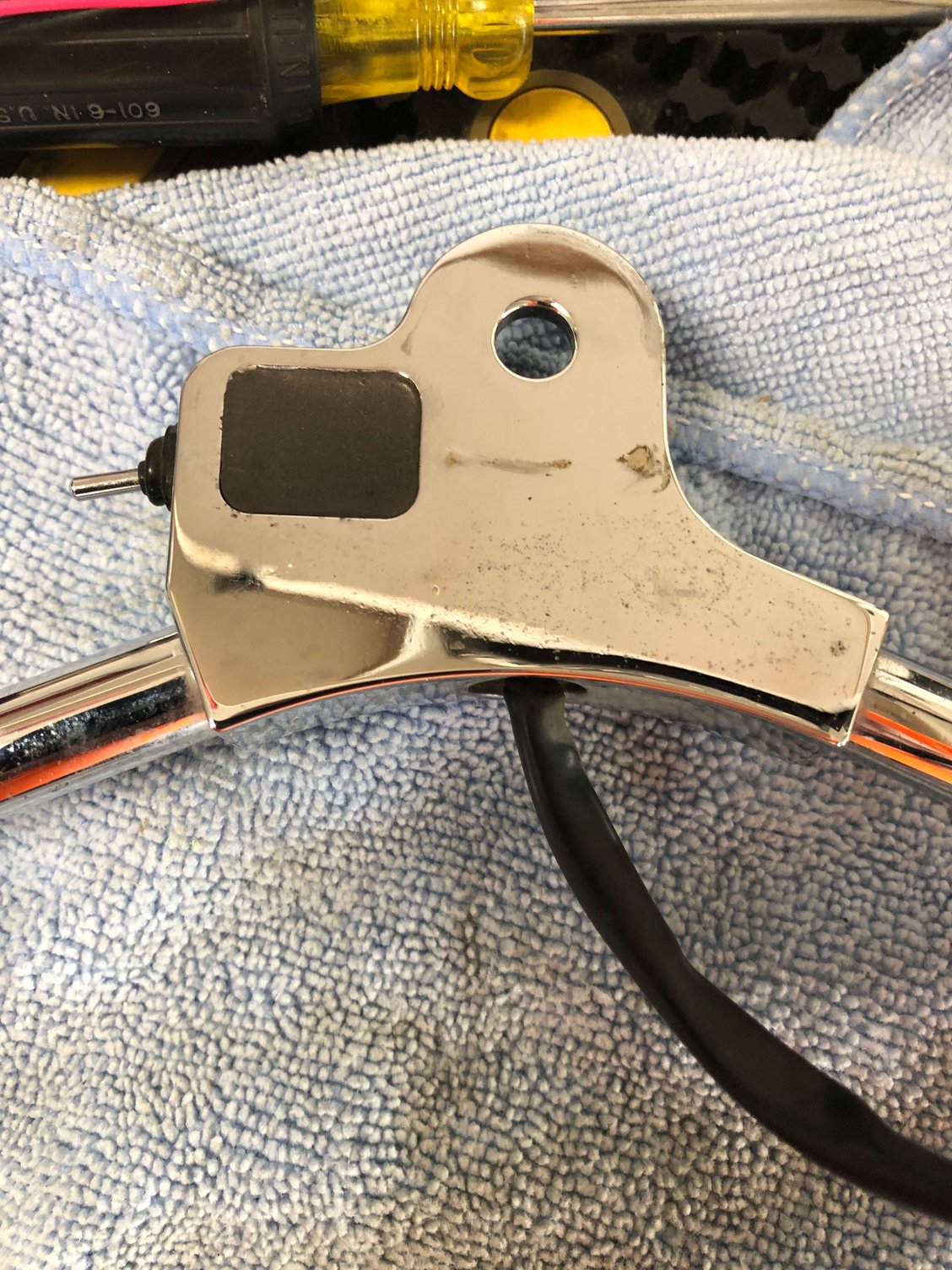

Ok, so my replacement fan has arrived. I have the housing on the bench. On the backside of the housing is a void that looks like it has been filled with some type of compound of unknown origin. The switch and fan connections are underneath it. Has anyone been inside there? Drill it? Heat it? Chip it out?
Identical
Connections must be under there
Reflective heat barrier
Another view
The failed fan motor was missing the heat barrier

Dig it out, it's silcone. That switch is tough to get in and out. I looped the wires in the holes after cleaning. Then soldered it once in place. I rerouted the wires on the fans so the openings on the circuit board are pointed down, for drainage.

[QUOTE=xcbullet;18162978]Dig it out, it's silcone. That switch is tough to get in and out.[QUOTE]Tough to get out is an understatement. Did you get it out intact or did you cut the wires? Looks to me like there’s not enough room in the void to move the switch back far enough for the switch lever to clear the housing.

I cut the wires first, then there is just enough room. Ya I think the opening could of been a bit longer ��
