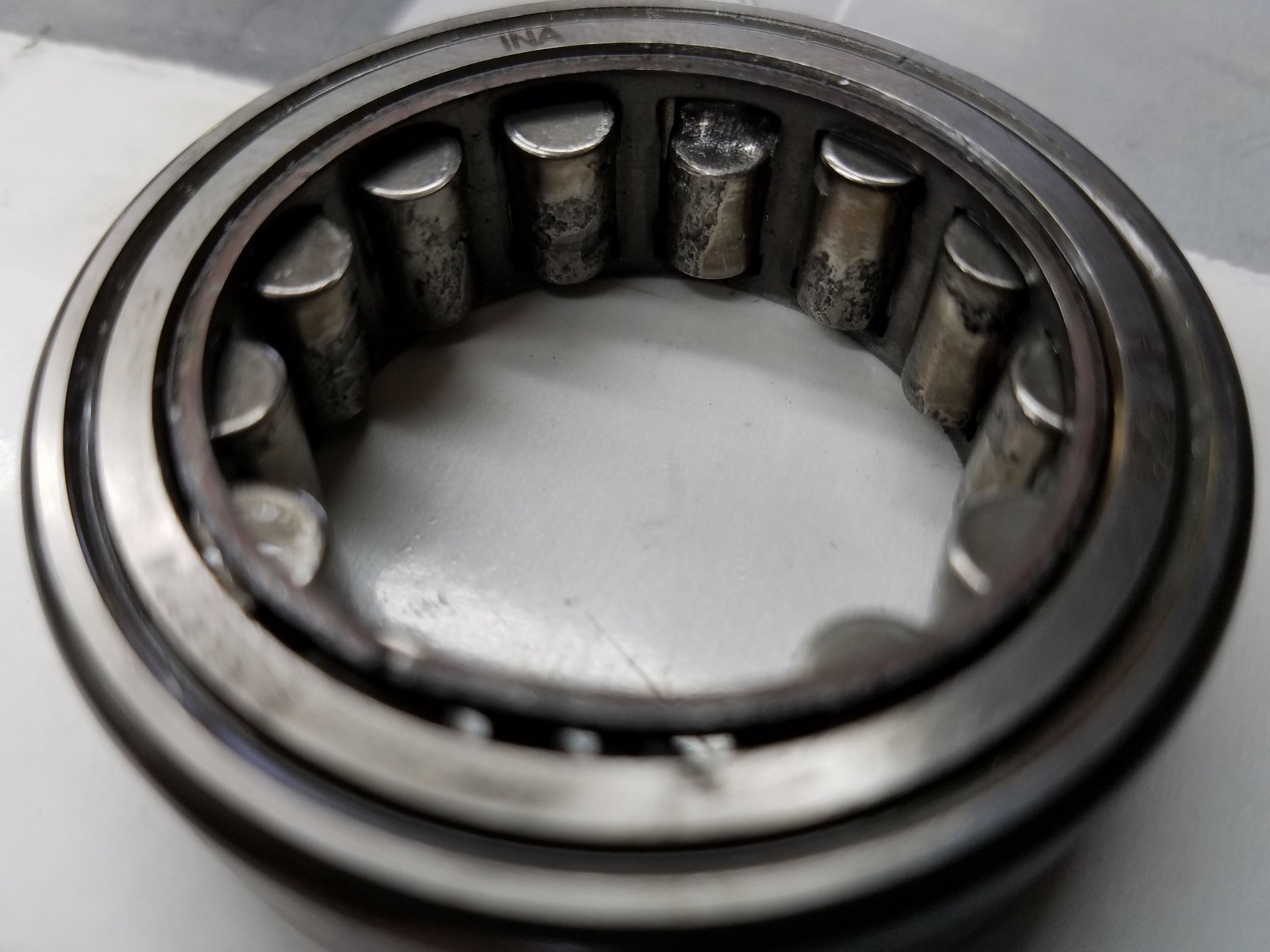

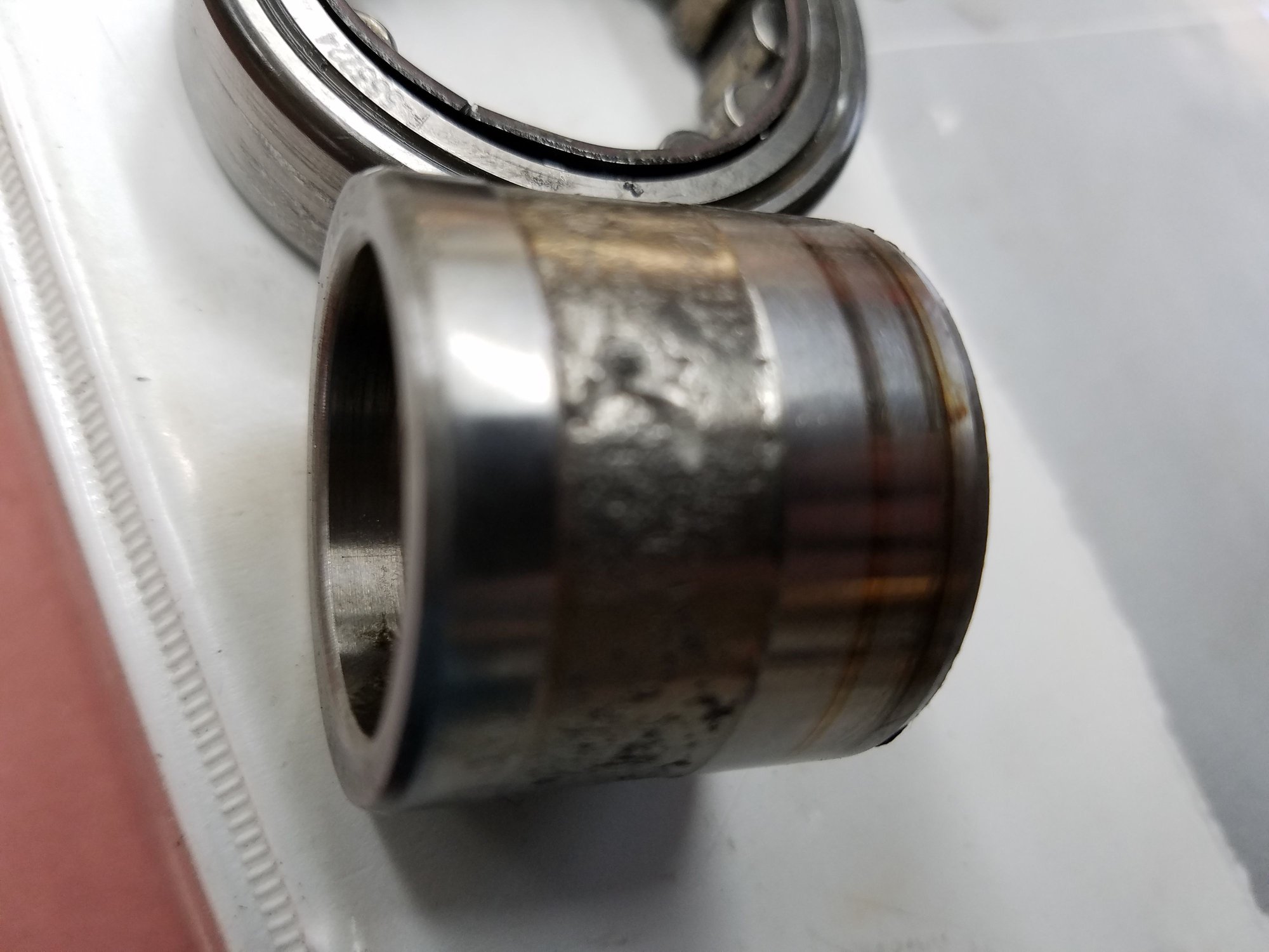

I have had the original Baker unit for a few years and have had no issues at all. If the upgraded unit is better then you should be fine. They are also offering the upgraded parts for those of us that have the original units. I ordered the upgraded parts today after replacing the IPB on my buddies 09 Road King.
When we pulled the primary cover off the stock chain adjuster had ratcheted up so tight there was very little play in the chain. I have heard about this happening but never seen it myself before. Pretty good odds this played a role in his bearing going bad. It took out the sleeve on the transmission output shaft the bearing rolls on as well.

Were there any symptoms, unusual noises or vibrations that caused you to go in and investigate the IPB? Thank you for the pictures!
I have just over 100K on my Ultra and I think my IPB is also shot. I hear noises with the bike in neutral with the clutch both released and pulled in. Noise seems to go away when I put the bike in gear. How did you press out the bearing? Did you use some sort of socket under the press on top of the bearing?
