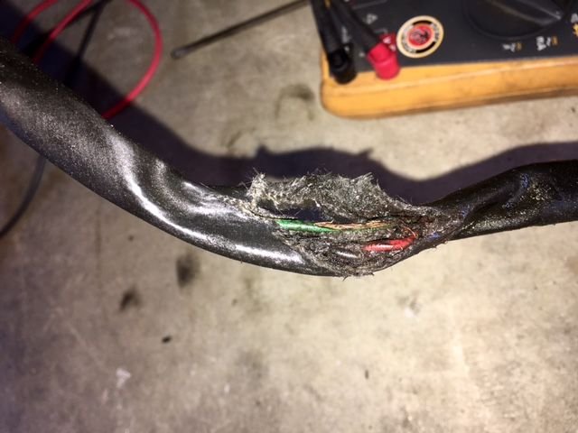

I agree about the switch, but I don't think it would be throwing a crank sensor error code if it was the switch. I did replace the crank sensor and still the same thing. I got out my ohm meter and started checking wires. The crank sensor has a black and a red wire. The red wire has continuity to the ECM. The black wire appears to be open, no continuity between the plug in the ECM. That may be the problem!

Problem found and fixed. So I replaced the CPS and same thing, same code. After some troubleshooting with my ohm meter, found no continuity between the CPS harness and the ECM. Pulled out the harness and here is what I found under the bike against the frame.
Old Jun 26, 2017 | 01:09 PM
Pumba11's Avatar
Pumba11
Joined: Jan 2007
Posts: 4,020
Likes: 69
From: Twin Cities, MN
That will do it!
Good find.
