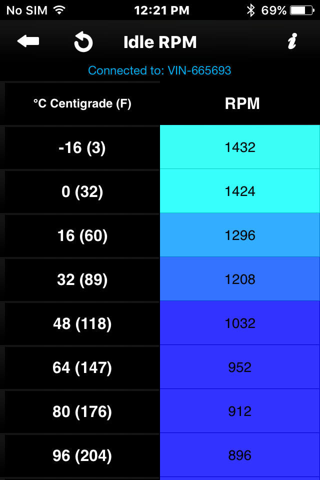

with a V&H fuelpak 3 you can look at and alter the idle tables if you want.
the high idle is required for oil pressure and volume- with is part of the cooling system and eases expansion of the steel vs aluminum parts when warming up.
here's a pic of my tables ( edited about 100 lower across the board) showing temp and rpms
mike
