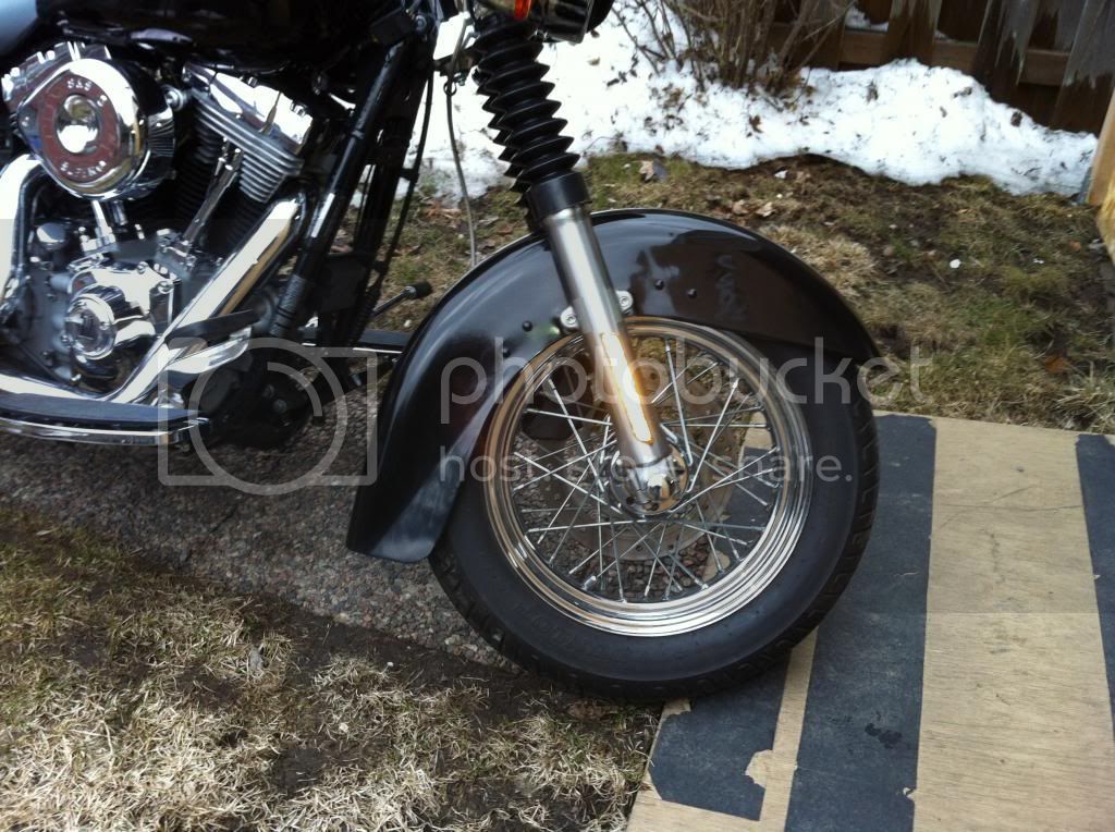

There are some aftermarket Heritage/Touring style front fenders made to fit the Wide Glide & Softail Custom forks.
From here on the forum- Converting a Wide Glide to FL style
ETA- the 19" wheel & tire is right at 1" taller than the 16". Your 19" should fit with that fender.
