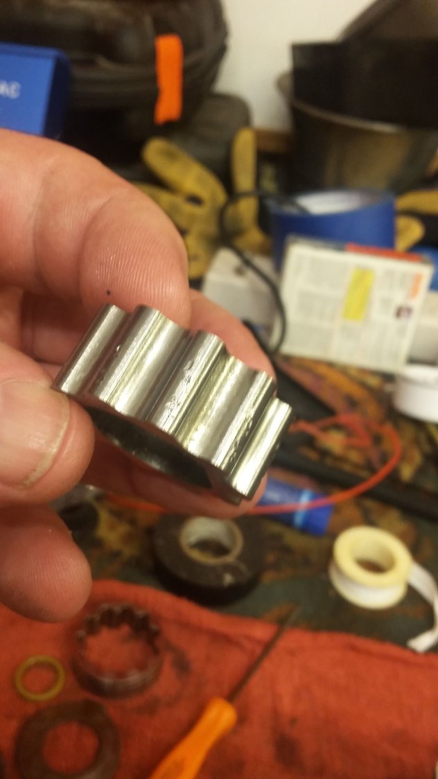

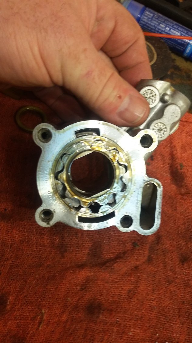

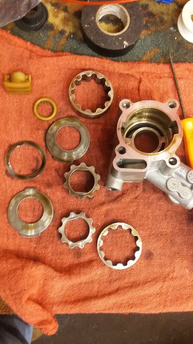

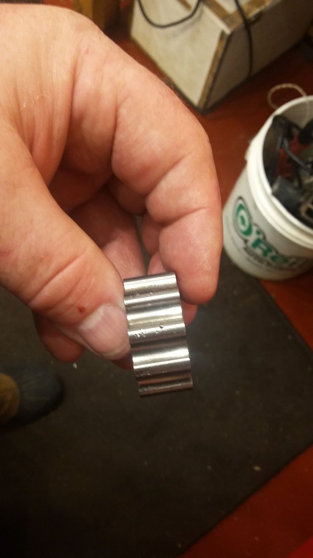

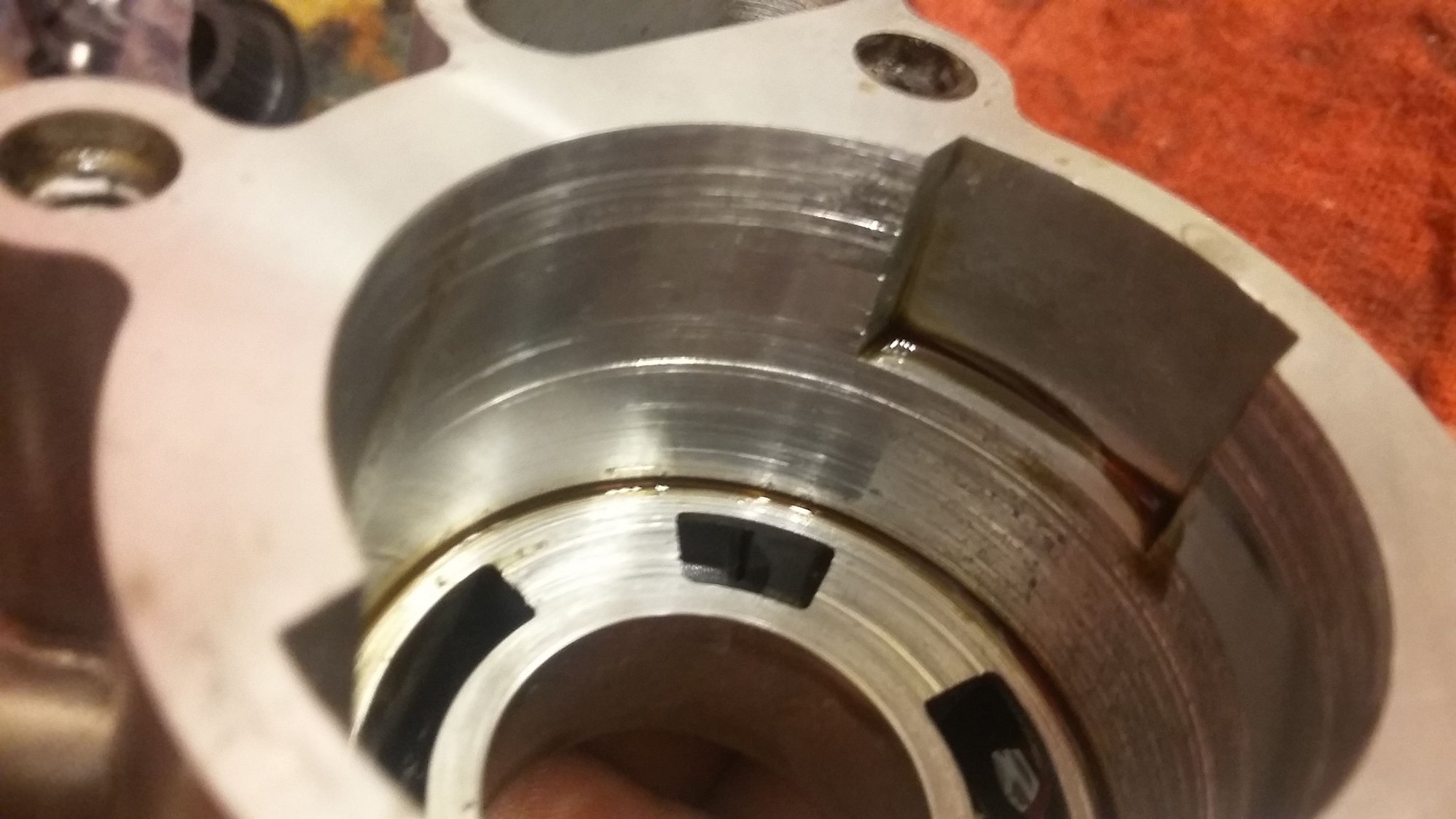

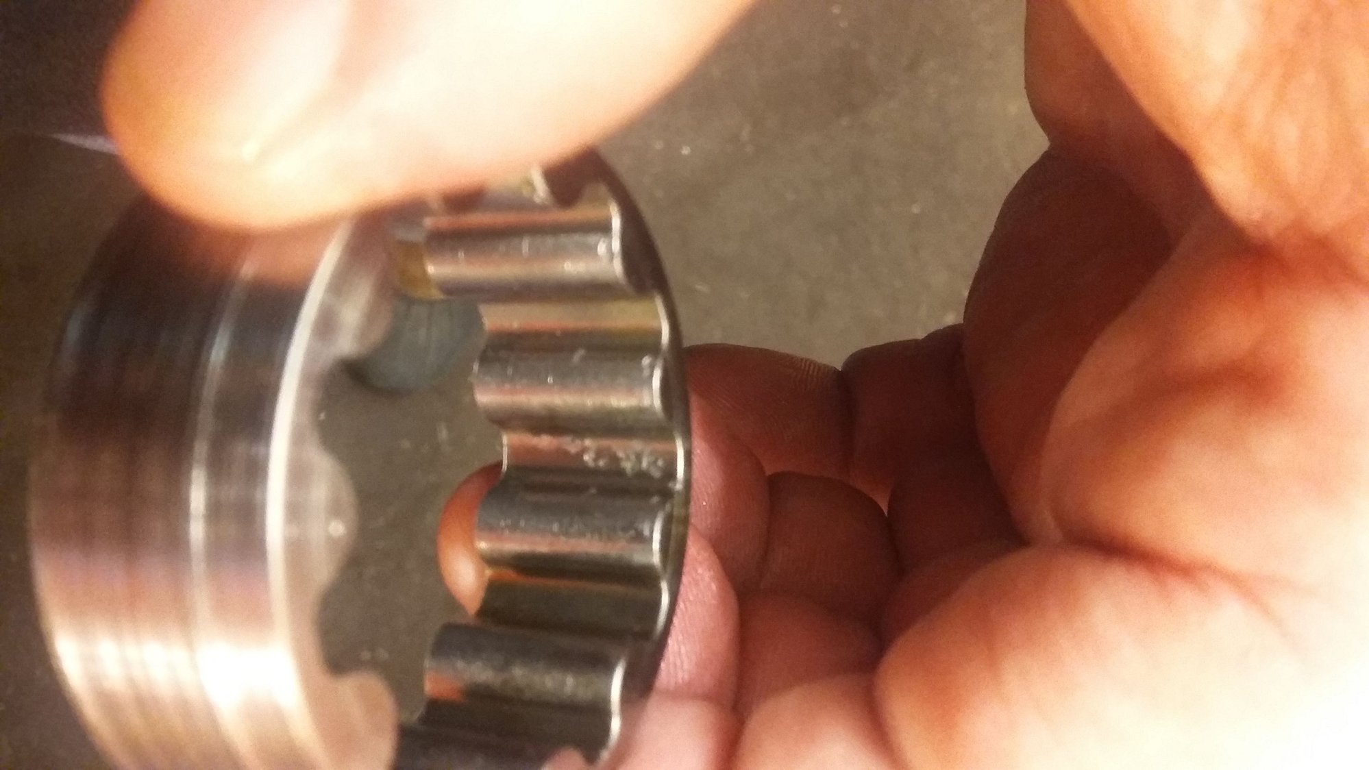

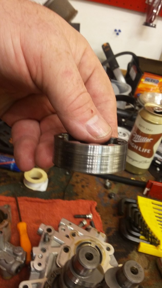

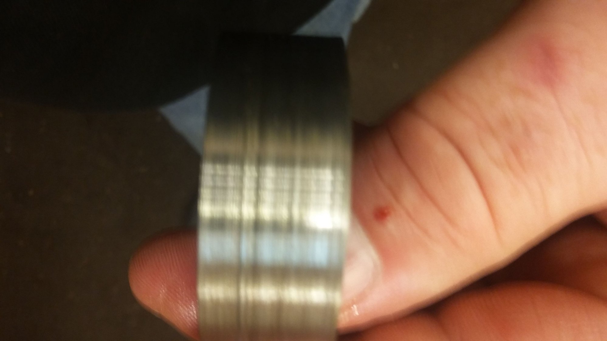

Got some work done on the bike today. Pulled the oil pump and took some pics.

Well it actually looks better than I thought it might, I've seen some where the gerotors were broken. You could take the oil filter off & cut it open to see what's all in there, you might be lucky & have little or no damage to the internals. At this point I'd decide on who you're going to take it to, I think you should take to someone that can do the whole project. You have 2 very good recommendations, both Bob @ Razorback & Randy @ Hyperformance are very well respected & know what they're doing. I'm not sure if Bob can sleeve the lifter bore but he can do everything else that's needed, he's in Wi about 135 miles east of the cities. Randy is in DesMoines & I know that he can do everything, he can even rebuild the flywheel if needed. I'm not sure where you're located in MN but I would give them a call & tell them what you have & get their opinion. You could just take the engine out & take it to one of them & they can tear it down & let you know the best way to proceed, good luck.

The carnage to that oil pump indicates to me that you are going to have shavings thru out the motor. Also, in the last pic, I see a solid sprocket instead of a compensator and a final chain drive. Tells me the previous owner may have been aggressive to the bike. You already have the TB, injectors, and clutch for a 124lc....I'd go that way.
Agreed.
