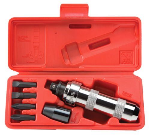

An Impact Driver with the right size bit such as this may work too.
That is what they are designed for.
