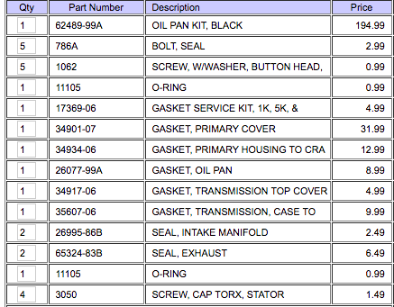

So . . . I'm in the process of removing and replacing my engine. Does anybody know where I can find a complete list of all gaskets, bolts, seals, etc. that I need to replace as part of this project. This is what I have so far:
Am I missing anything? I know that some of things are not on the must replace list (oil pan and gasket, transmission top cover gasket).

might want to hit up these guys and ask what they have kit wise otherwise it's listed by application.
http://www.cometic.com/p-35445-v-twin-cruiser.html
You're looking at an S&S replacement motor. Do they offer a kit or at least a listing of exactly what you need?
