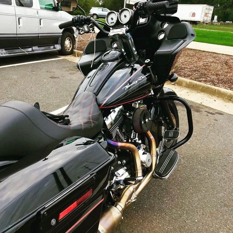

Originally Posted by gartec81
Anyone know what company makes that exhaust? Trask?

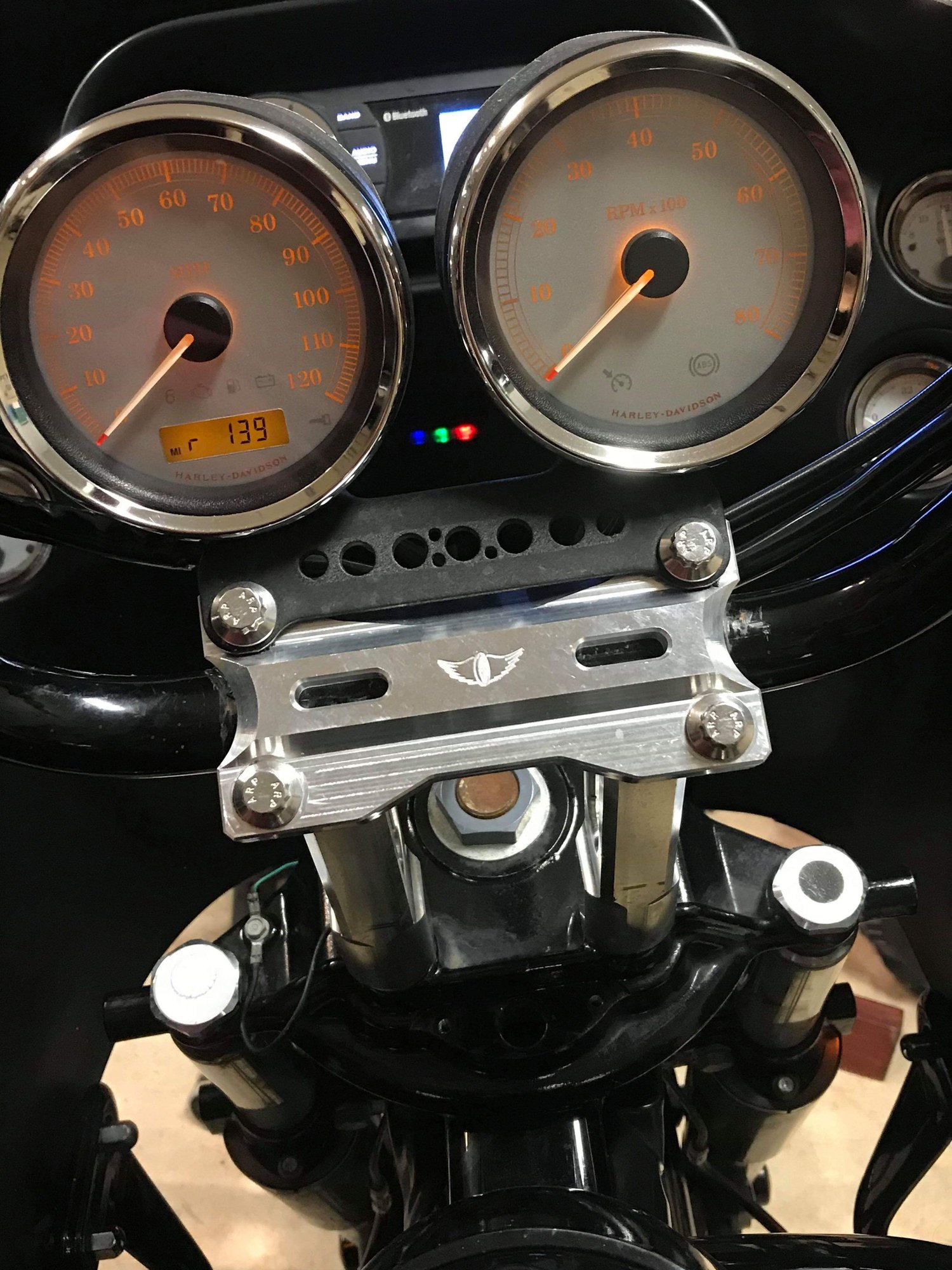

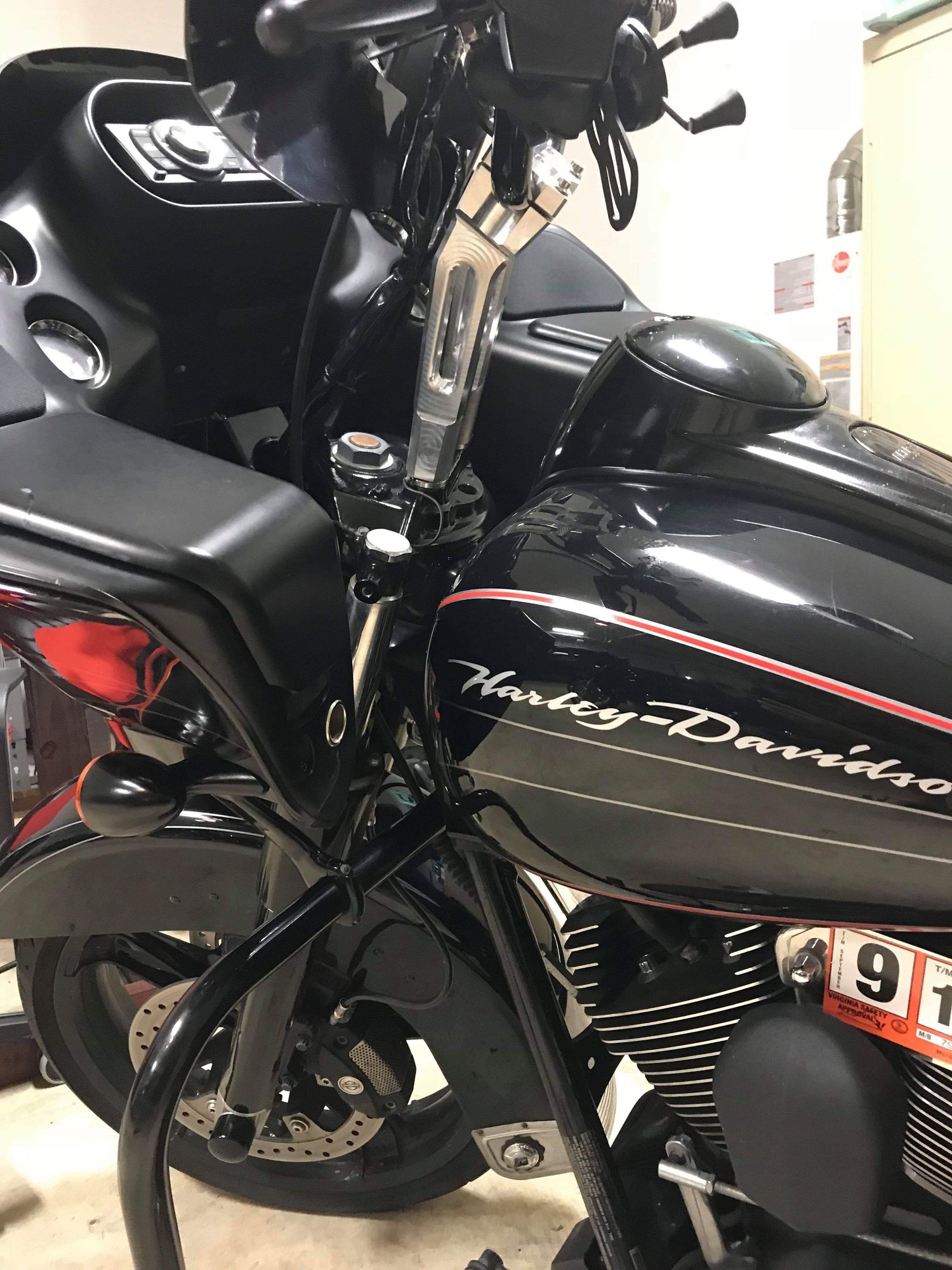

She’s finally getting where I wanted her to be . Couldn’t afford /justify 600 bucks for gauge mounts so i used 24 dollar 04 fxd mount. Hidden ignition toggles and inset indicator light bar under the radio
I need to relocate my gauges up to my bars too. I cant stand not being able to see them behind the risers. Was it pretty straight forward? I assume everything needs to be extended?
that depends man. I can only speak to the 2013-older Since mines a 12. A Dyna gauge mount won’t work on the newer gauges for one. But I’m terms of wiring, no I didn’t need to extend anything for the gauges . I did take everything off the triple tree and replaced the huge ignition switch with another toggle setup with hidden killswitch style button . And dremeled out the fairing for the toggle and indicator light bar. But other than that, all the wires that go to the gauges were plenty long
he made it himself. That’s dale yamada of mjk performance bike though he sold it earlier this year
seems awfully similar to the newer tbr
he made it a year before the tbr was released
